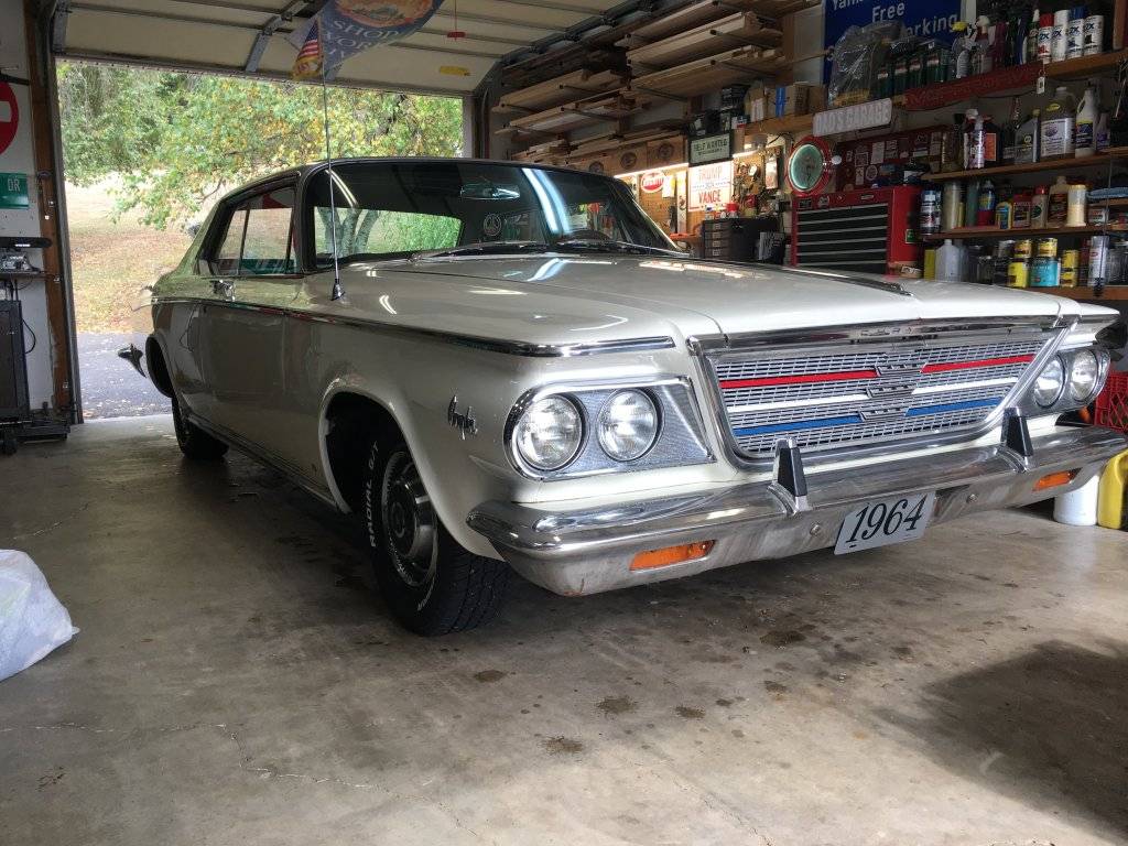

Just had a complete rebuild on my 64 Newport transmission. Push button gear selector, 727 auto. Upon first start when cold, the car rolls forward a bit. Definitely unnerving. Has anyone experienced this? Before I bring it back to the shop. Any information is greatly appreciated, as always, from our vast group of knowledgeable Gentlemen here.
