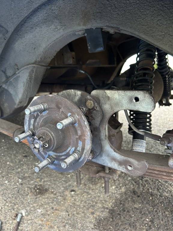

Thank you I appreciate it , I believe someone had put a rear disc break kid on my car at one point I believe it’s for a later model because the manufacturer told me they don’t list kits for my year vehicle
Yea, no disc brakes for that year. While Chrysler did have a very complicated version of a disc brake in the 50's, they were pretty rare.
I think 1966 was the first year for optional factory installed front disc brakes, although I know 1965 had some dealer installed front discs (not on C-bodies). Rear discs didn't appear until 1974 Imperial.
So, yea, that's gotta be a kit. The good news may be that they used a lot of standard "off the shelf" parts in those conversions. Usually a Ford or Lincoln rotor and GM calipers. You might be able to match them up, but the easier method might be to swap rear ends to something slightly newer. That gets rid of the tapered axles that can be tough to deal with too.
