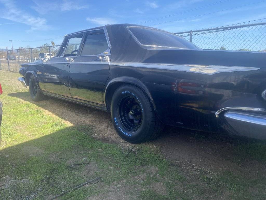

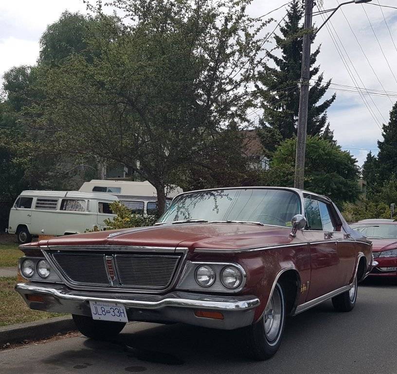

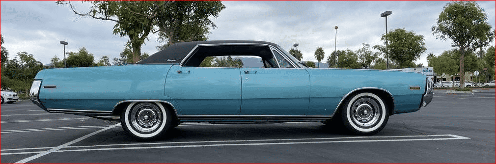

I am in need of replacing my tires due to the age of them from the car sitting so long before I purchased it in November.
While I love the look of the wheel covers the car has, I am less than thrilled by the lack of tire options in the 215/75R14 size range, so I am exploring the possibility of moving to a larger diameter wheel for more tire options as well as reducing the size of the sidewalls for better handling. I am looking at the possibility of going to an 18 inch wheel as it provides the best options for tire widths while maintaining the circumference of the tire to match up to original equipment to keep the speedometer and gearing as close to stock as possible.
I'd like to keep a classic look to the wheels and not go muscle car or too far new generation as I think it drastically changes the look of the car. Also, not looking for a very "open" wheel as the brakes underneath won't be all that pretty.

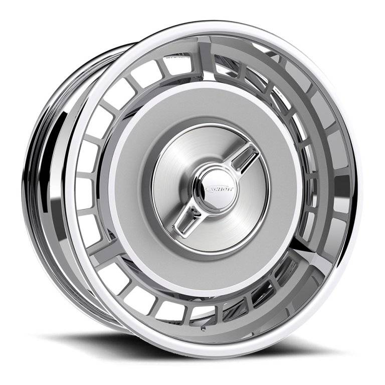

I came across these Schott Bel-Air's that I think would be perfect, but they are around $2,500 per wheel, which a set would be more than the car was.
Does anyone have any recommendations of larger wheels they've seen work well on these cars? I'm open to any ideas.

Thanks for the recommendation. I've seen these wheels around and on cars and feel they change the look from classy to sporty and I'm trying to avoid that if I can. Wheels look great, I just see them a bit more in place on a 2 door or sportier body style

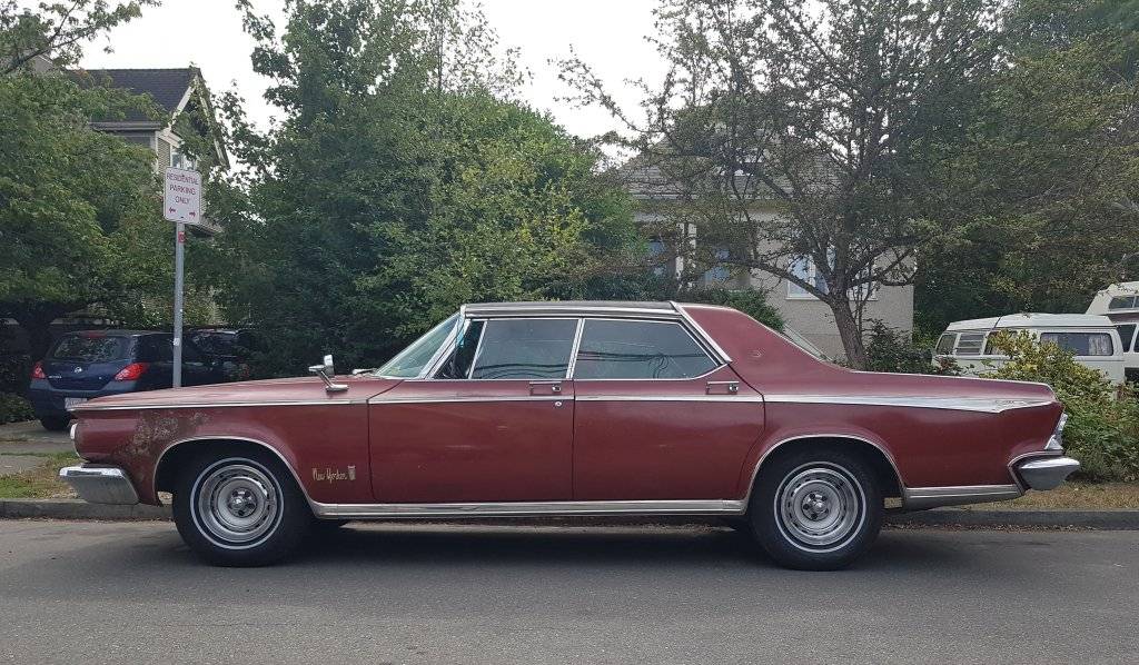

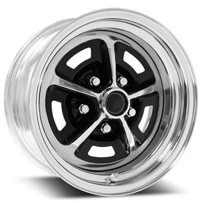

You could go with a Magnum 500 type wheel. These were factory options for 1967 B-bodies and up. They became available in the aftermarket around 1965, so it could be a "Day 2" type wheel and it's still a Mopar type wheel (although Fords got them too). They are available in the aftermarket now, all kinds of sizes and not crazy money.
Here's a few cars with them. Put Magnum 500 wheels on my '68 Chrysler

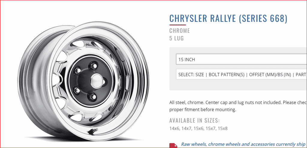

BUT finding a 15x6.5 or 15x7 Chrysler factory wheel will be an improvement. Then you can seek out a set of the 1969-197_ factory wheel covers which look very similar to what is now on the car. That would maintain the "luxury" look you presently have.
The wider wheel will help handling with a P215/75R-15 tire as the tire sidewall will be more vertical to the ground, rather than being bowed with the narrower rims. It can make a surprising difference, from my experiences.
The issue with 18" is that no whitewalls are available for those sizes in "modern rubber". PLUS the wheels will all show the "needing attention" brake drums. There is ONE wheel which mimics the 15" GM Pickup truck Rally Wheel, which is also very similar to the W23s, but with the GM styling cues on the center caps and such. If tha tone is available in 18x7 size, with 4.0" backspacing, that might be an option. But people would want to ask how you got that Chevy pickup truck wheel to fit your Chrysler, I suspect. Seems like Vision Wheel has it? With the Chrysler bolt pattern, might be able to use the W23 center caps? Maybe even use some of the B/E-body rallye wheel wheel centers?
The 15x7 "cop car" wheels are in repro, but some looing around might find some in the salvage yards, too.

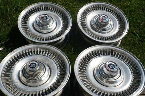

I always thought the Kelsey-Hayes wire wheels look good on these cars, up until '65 anyway....... Wheel Vintiques has them, not cheap by any means, but with the 2-prong spinner, is a period correct (almost, anyway) look for the car, AND you don't have to worry about wheel covers flying off.......

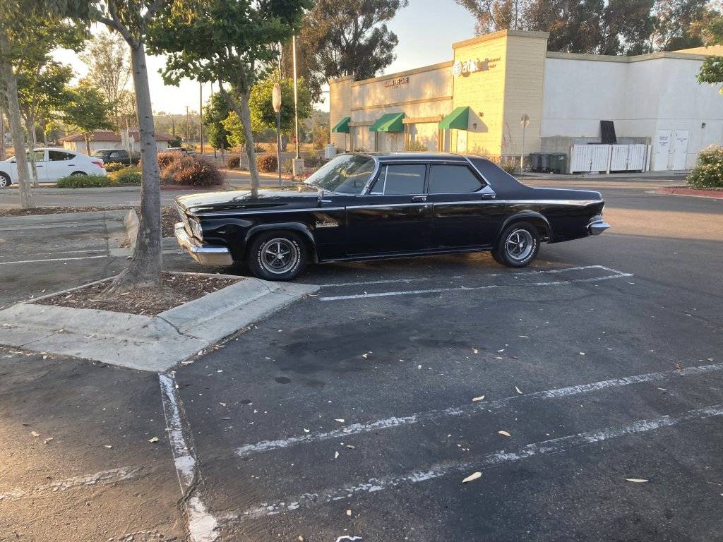

I don’t think either of these are the style you’re looking for, but just posting my wheel journey. For the longest time I ran the 14” Magnum 500s on my 64 and they looked great. Just recently I upgraded to American Racing AR23’s (15x7 up front and 15x8 in the rear, 245/60/15 and 275/60/15 respectively). I think the 15’s fill the wheel wells perfectly and give a nice blend of simplicity + aggression. Again, probably a bit too sporty for what you’re looking for, but just offering options.
Car looks great with both sets. I think your black car with black wheels can get away with the sporty look or just on the second set, the overall darkness really nails the mostly all black look which is classic.
I love the meat in the rear.
Also the way the side trim finishes in the rear on the 64’s adds a bit of sport that the 63’s leave a little plain.
