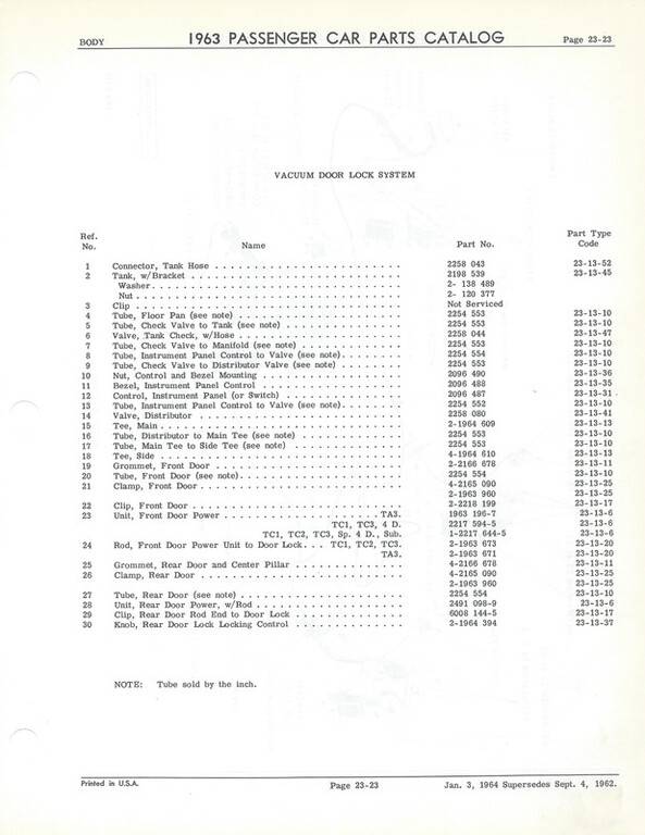

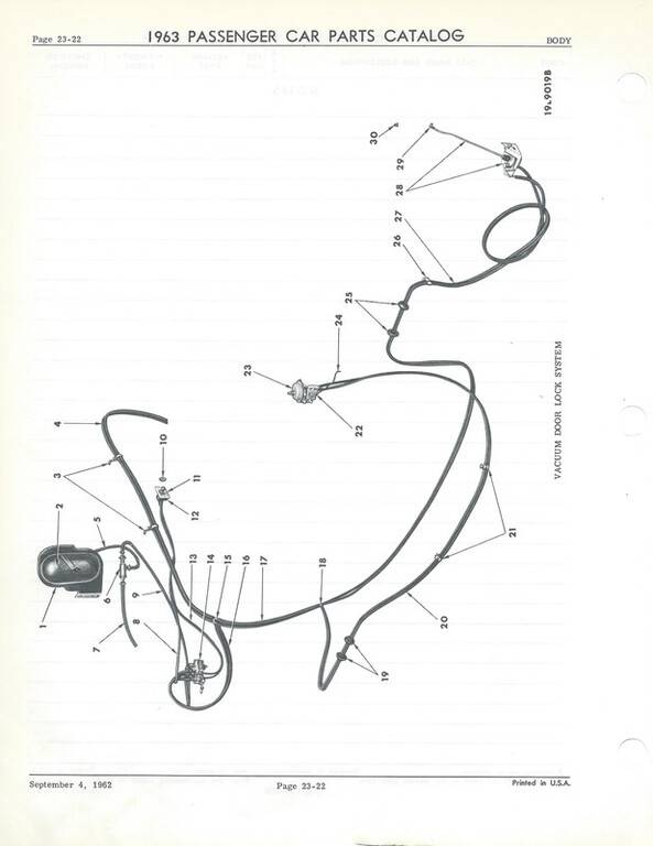

Looked ,in the parts book only shows it this way . No pics of the doors. This is the 63 book but 64 shows the same. TA3 is the parts code for 880,s

My 64 880 has them , if you look in the parts diagram TA3 denotes 880,s.
