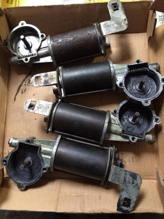

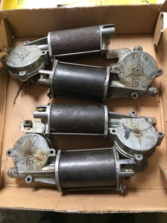

WANTED 1965 300 window motors

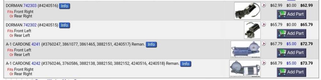

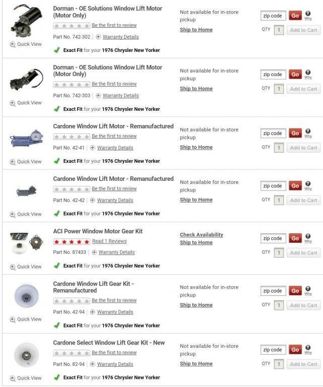

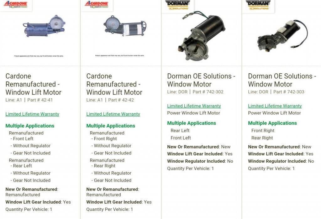

Dorman makes new replacements for $40. Part# 742-300 and 301, 2 of each does both sides of the car.
The link is for a 71 Newport but Mopar used the same motors on all cars from the late 50's to the 90's. The only difference was the connector plugs and the Dormans come with all the different adapters.
http://www.summitracing.com/int/parts/rnb-742-301/overview/year/1971/make/chrysler/model/newport
