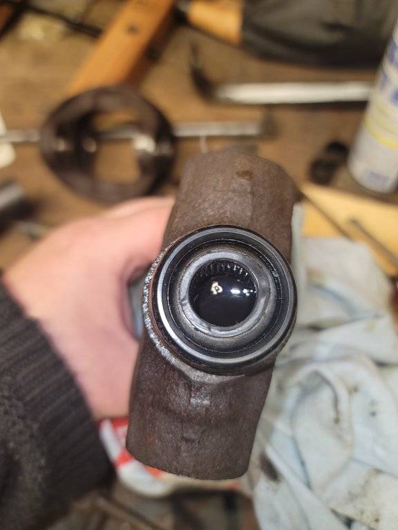

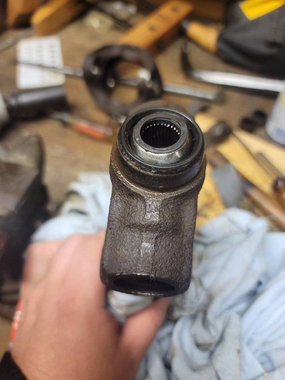

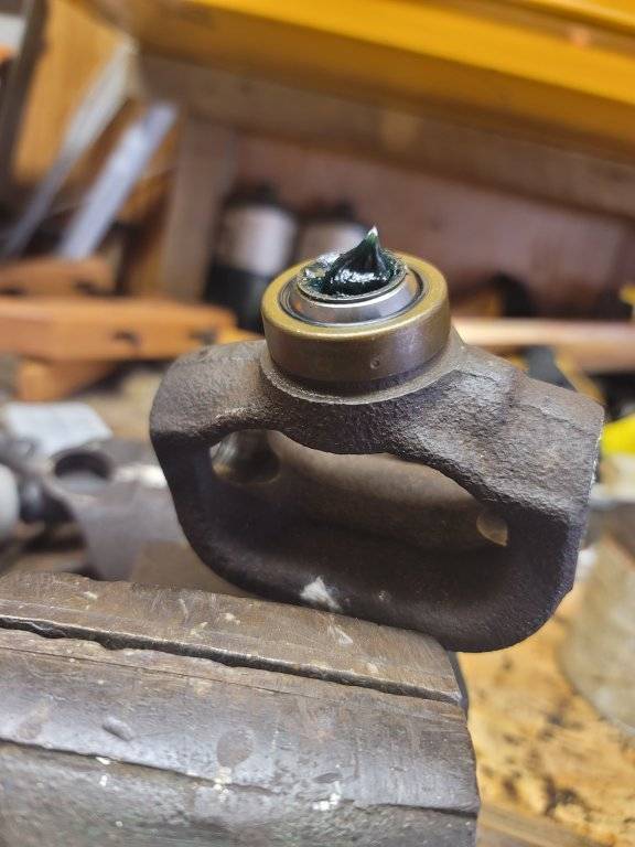

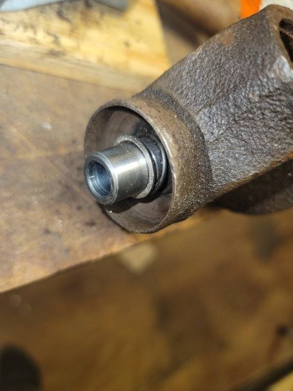

Well I just found out that my 1964 imperial actually has a 1965 drive shaft! I don't know if the original owner placed it on the car or If it was from factory (my car was produced in June of 1964)
I'm about to replace all of its parts,u joints, ect. but does anyone have any part numbers or links to a new ball and spring for inside the cardan joint?
Thank you in advance!

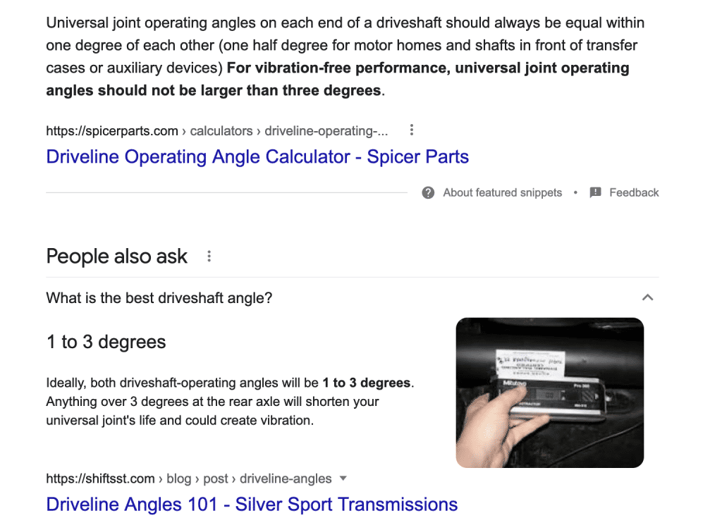

U joints are very particular about angle. Too much - like a jacked up 4x4 - and they won't last, but no angle is equally bad, causes a lack of rotation of the needles, and wipes out the crosses.

Apparently 1-3º is best.

I actually found an exact match for the ball and spring in the double cardan joint! GMB 261-0616!
I did tons of research and found old Dana catalogs that listed 1966 Lincoln Continental along with Imperial sharing the same part! Dana no longer makes it but GMB does.
Went right to rockauto under the 66 Lincoln and there is was!
Re driveshaft angles: There are three areas where shims were used on our 64-5-6 Imperial driveshafts: 1) Under the driveshaft bearing carrier in the middle, 2 and 3) between the attach points (left and right) of the rear torque arms that ran from the rear axle to the chassis. This suggests that even in a "normal" ride height car there was still room to account for production variance of a degree or two that required correction.
