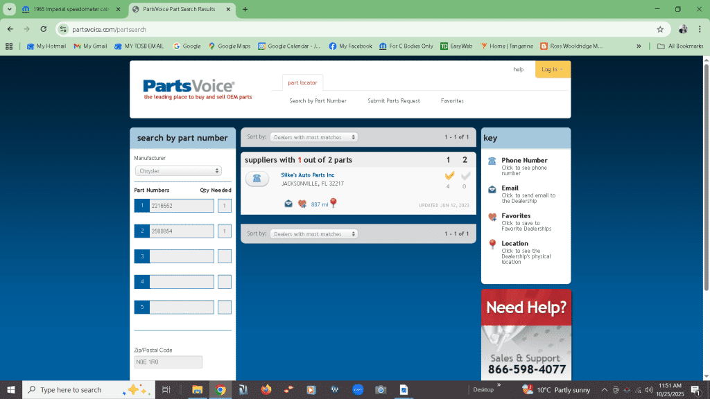

Does anyone know where I can buy new speedometer cable that go for my car with auto pilot?
G.
Your trans to Autopilot servo cable (lower) is part # 2580 854
Your Speedo to Autopilot servo cable (upper) is part # 2216 552
Start with Murray Park in Tiffin Ohio (www.cbodies.com)
Bob Hoffmeister at Imperial Heaven (Hoffmeister's Imperial Heaven | Chrysler Imperial Specialist)
Silkes Auto Parts shows 4 of the upper cable
