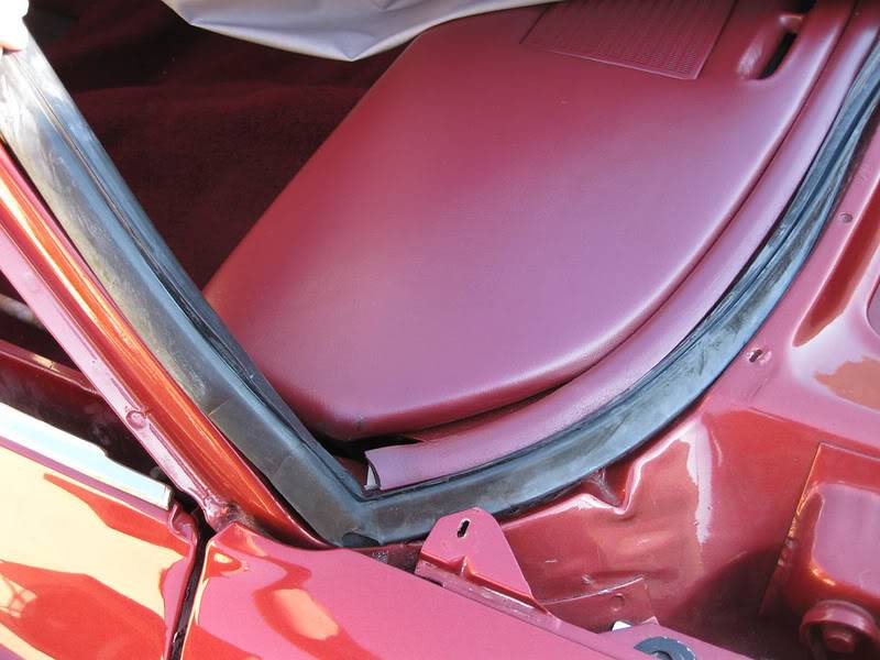

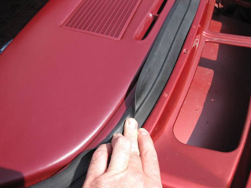

I dug up some pics showing the difference in the incorrect Steele Rubber reproduction windshield gasket vs. the correct NOS windshield gasket. What Steele Rubber called a replacement isn't even close.
Incorrect Steele Rubber gasket:
Correct NOS gasket:
