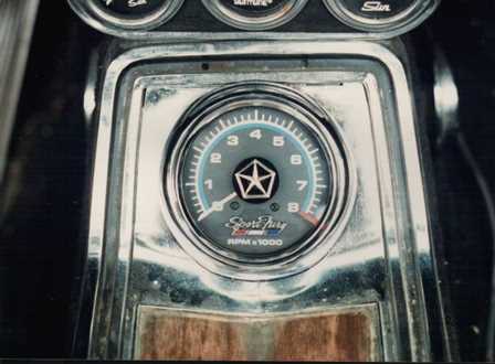

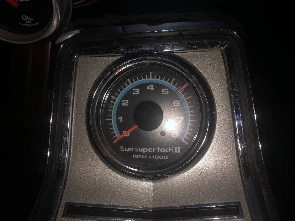

To me this is the ubiquitous tach.
You can see my redline is set at a slightly more realistic 4000RPM rather than Badvert65 8000RPM but I'm guessing the needle is stuck there.

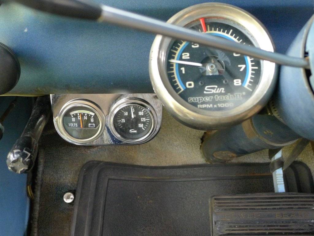

Nice old Sun gauges btw.
My favorite old gauges are now Sun and not SW like in the old days, Sun was too new then and SW considered the best, now just China poop.
My favorite oil pressure gauge is this old Sun 150 psi racing gauge I had to talk an old timer out of, he had it on display in his house and it took me a coupe years to get it. The rebuilt 318 gets 75psi on cold mornings and the last gauge was full of oil, about ready to start dripping on the carpet.
It's hooked up with copper tubing, the right way.

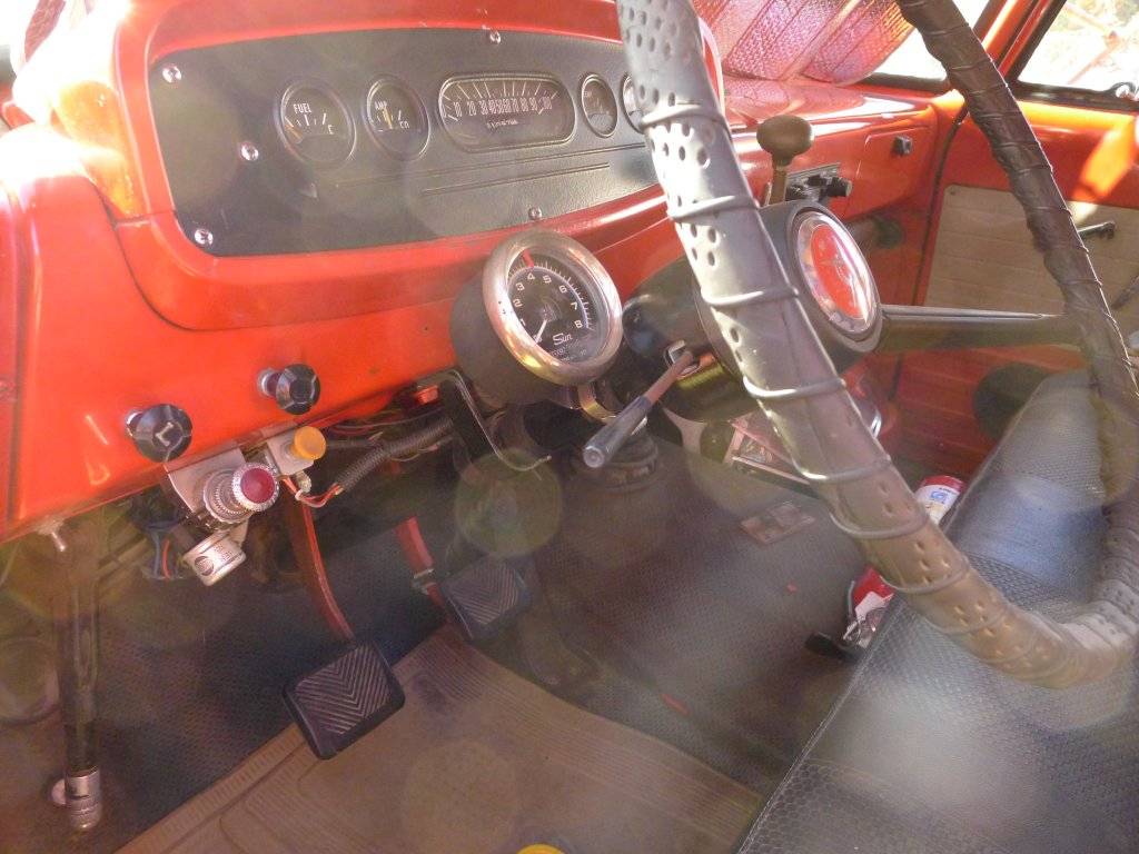

And a Voltmeter, about 10 lights years away from the ammeter, which is always bypassed for me via a 10 gauge lead going from Alternator + to Battery + under the hood, usually passing in front of the radiator. This unstresses the ammeter in the dash from charging the battery, but it will still show draws like key on or lights off with engine off.
This is the tach that was in the red truck, now decommisioned and sitting with empty gas tank.

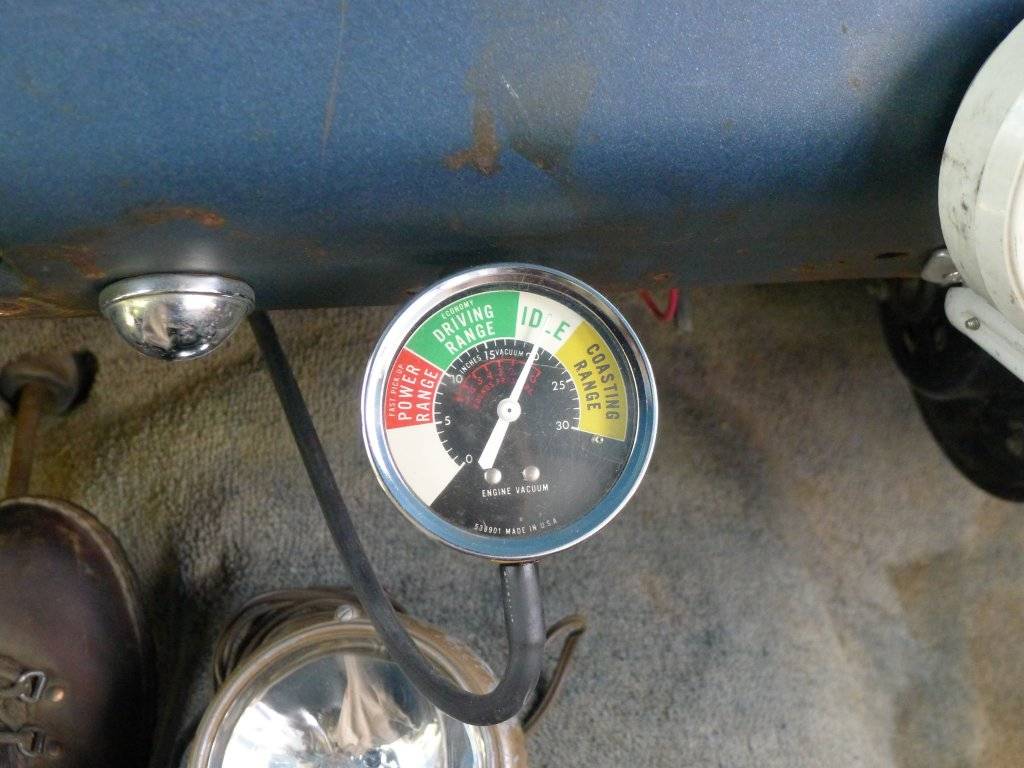

And a permanently installed old fashioned vacuum gauge plumbed from the manifold.

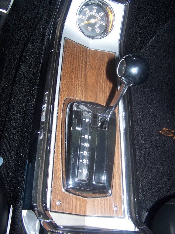

This is what the 65 factory installed unit looks like. It goes in from the bottom side and needs a sending unit that mounts to the underside of the console.
I sure wish someone repopped a tach with this original style face . . .

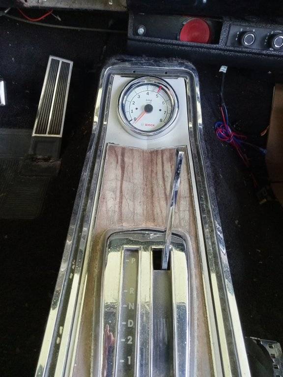

I just got my Actron Bosch SP0F000020 Sport II 3-3/8" Tachometer (White Dial Face, Chrome Bezel) from Amazon. The price was $54.99 and it looks really good and fit really good too. I will need to figure a way to secure it in the hole. I am not ready to mount it yet anyway. The AC is just sitting in place, almost. It needs tweaking too.
Mine has been "just sitting in the hole" for 33 years; not a problem! Sun tach, easy install!
