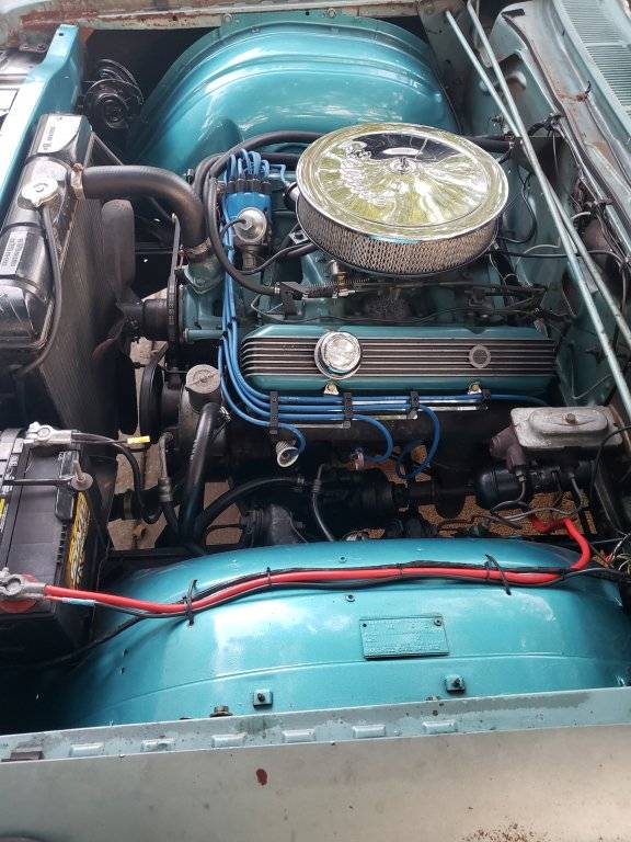

I have a engine surge that's going to be the absolute death of me. Engine is 383 with slight upgrades. 512 heads with hardened seats and bowled, comp cam k kit for Chrysler, Edelbrock AVS 2 650 , 1 inch aluminum carb spacer. Electronic ignition conversion, NGK plugs and Taylor 8mm wires. I've upgraded the fuel pump, still mechanical. Carbs getting 5.5 psi. Problem just developed and I can't seem to trace it out. Any suggestions would be greatly appreciated.

It appears it was the carburetor base gasket under my 1 inch spacer. Now if I can only figure out why it's such a dog in first gear. Top end runs great, off the line she doesn't want to get moving.
