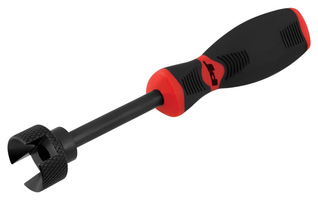

I feel your pain. I have had good luck using this tool. Wrap some masking tape around / over the business end of the tool. It helps grab the bulb without breaking it:
