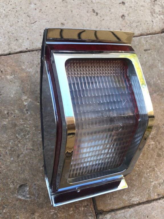

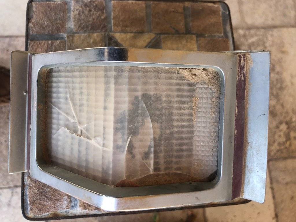

Here is a little trick I learned when I was looking for tail light and back-up lenses. I was able to always find many cracked but not perfect/good lenses during my restoration project but I learned how to mend plastics from working with plexiglass.
If the lenses are cracked, or even broke for that matter but complete, clean them very well, let them dry thoroughly and using a syringe, can't buy them at a drug store but on e-bay and Amazon, inject "WELD-ON #3 into the cracks. It literally "welds" the crack together to the point you can't even see it (chemical reaction). Use a little masking tape if necessary to protect required areas because the WELD-ON is very thin but, not so much a problem. Amazing result.
I have attached pictures of a back up lens that I bought for a song because it was broken and cracked and repaired, There are still some telltale cracks but these can be repaired with a second application but not how the broken part of the lens was repaired. Now that I have learned that trick, I will NEVER, EVER pass up a cracked or broken lens that can be repaired by this method if I can negotiate a good price because of the break/crack. Just a thought!

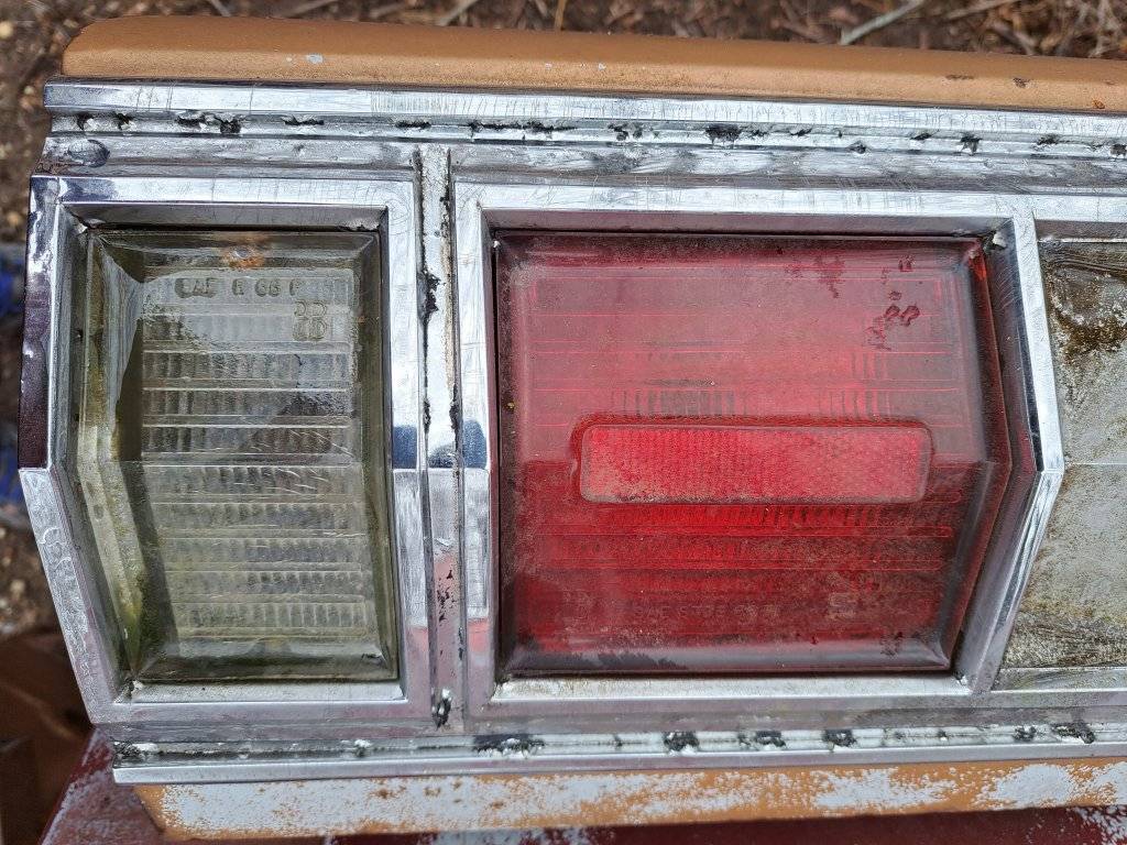

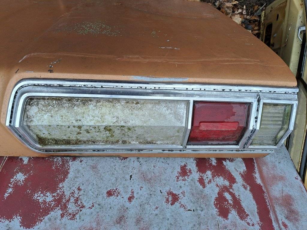

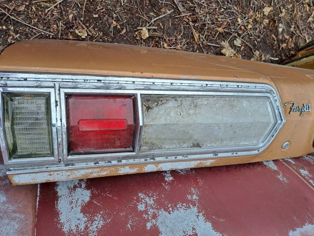

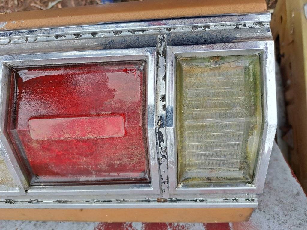

I finally took a look today. I have a set of lenses on a trunk lid that I have. They need to be cleaned (which I can do), but it appears both red lenses and one back-up lens are uncracked. The other back-up lens (passenger side) has a minor crack along the top edge. I'd prefer to sell the lenses with the housings/inserts as complete units. If you're interested, send me a PM.
The entire trunk lid, the lock and Fury III emblem are also available for anyone else looking. It seems to me that the trunk lid is pretty solid, but I would check that again to be sure. I also have some dash parts, grill, and exterior trim for a '66 Fury.
