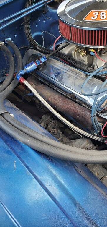

ONE thing to do soon is to get that braided fuel line away from the rh exhaust manifold. It might look good as it is, but WHERE it is can be a big concern. Getting it back to a factory routing would be best, similar to the OEM Carter AFB/later AVS fuel line routing.
Braided line might look good, having that "hot rod custom look", but also remember that inside of that braid is a simple rubber line which can be deteriorated by ethanol'd fuels just as an exposed rubber hose fuel line might. Hard line is best, which you can then polish with red Scotchbrite to a nice sheen, almost chrome-like.

Agree that fuel line needs to be changed.

The line appears to be real braided line which is actually very good. I would support it from the fenderwell to keep it from vibrating on the hardline that runs to the carb, or extend the flexible portion and eliminate the hard line all together but keep it away from the manifold. That line is in a much cooler location than the stock routing which runs behind the alternator along the block and gets significant heat soak.

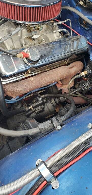

The only performance gain you would realize is long tube headers from tti. Depending on what other modifications were made to the motor they may be very small gains for the large price of tge tti's
Beautiful car! Unless i'm mistaken, that looks like a single pot master cylinder. If so, my top priority would be switching to a dual and splitting the system. Lack of power is nowhere as disappointing as lack of brakes. Also the ammeter bypass can prevent an unwanted barbeque event! Wishing you years of miles and smiles! Lindsay
i wouldnt bother with HP cast iron manifolds...too little performance increase for the bucks...especially on a car thats no longer "stock appearing" under the hood with your aluminum radiator, manifold, valve covers, braided stainless line etc...headers will flow lots better
