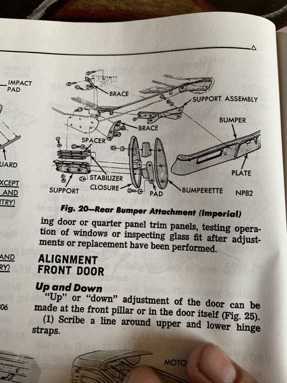

Inquiring how to remove the rear bumperettes on 1967-68 Imperial.
I have this image, from my Imperial book, but not sure.
Does the bracket “slide out” with bumperette, once you remove the
“Support” bolts?
