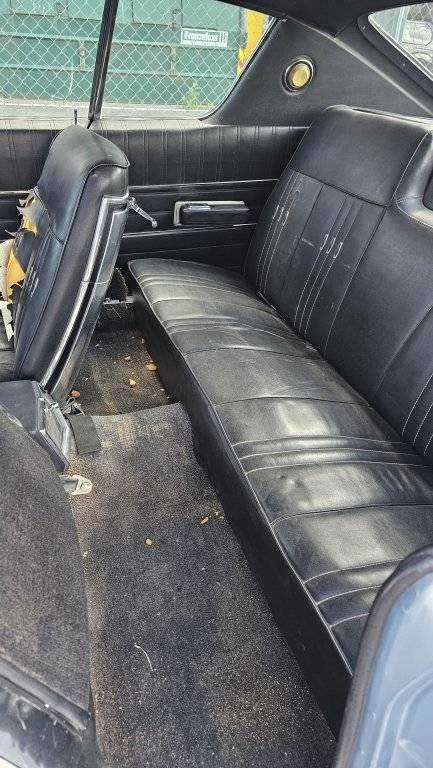

We are redoing the whole interior this winter (in an upholstery shop) with new seat covers, door and rear side panels and dashpad in artificial leather and velvet inserts by our design and choice of materials and colors. All the foam is dry rotted so it will get new foam with a bit more support on the buckets for more comfort.

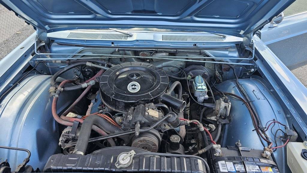

We really want to upgrade the whole electrical system too and upgrade the ignition with a complete kit from FBO Ignition.
Some upgrades in the engine bay with new wiring, hoses etc are on the list as well. The same goes for the trunk where we will clean and paint with some sort of anti corrosion stuff.
In that regard we would love to get some pointers and advice on parts to use and vendors to buy from. You guys have way more experience with these cars than us

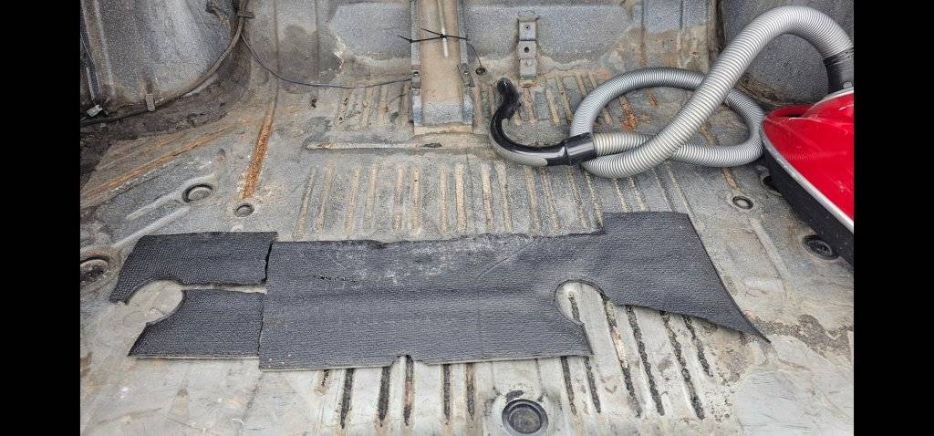

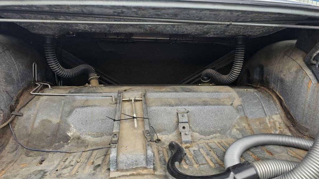

While on vacuum cleaner duty I found this dry and cracked piece on the hump between the drain hoses. What is it for and where can I find a new one eventually?
(Wiring harness in another '67 Newport in Norway?)
Not many to be found over here

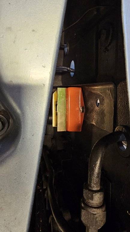

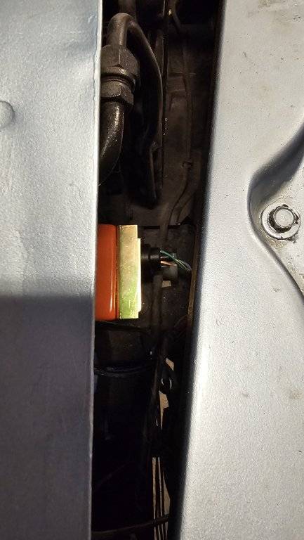

So you are considering it an "insurance issue" against future failures? I can understand that if the prior owner did things that compromised that. BUT it seems like a very lot of work for little real benefit if all is working well. The Ammeter Bypass, though, can be recommended without re-wiring the complete vehicle.
By observation from over the decades, sometimes people cause new problems as they seek to remedy the possibility of future problems, which tend to be very low on the probability of happening.
I'll admit that I had a wiring issue on my '67 Newport. One night it stopped running, suddenly, and everything run by the ignition switch didn't work, although things whose wiring did not go through the ignition switch still worked. I traced "the big red wire" feeding the ignition switch from the bulkhead connecter to the switch. THAT's where I found a completely uninsulated section where the PO had apparently wired-in something that was no longer there. It was touching nothing, but was a bad section of wiring. I cut it out and replaced it with a section that was OEM-style solderless connected with a new 10ga red wire. All was and is well since. Other than the terminal at the bulkhead connector inside terminal can now fall off, resulting in a sudden loss of power to the switch again, but as I know of that, I just plug it back in and proceed onward, until I can remedy that terminal looseness.

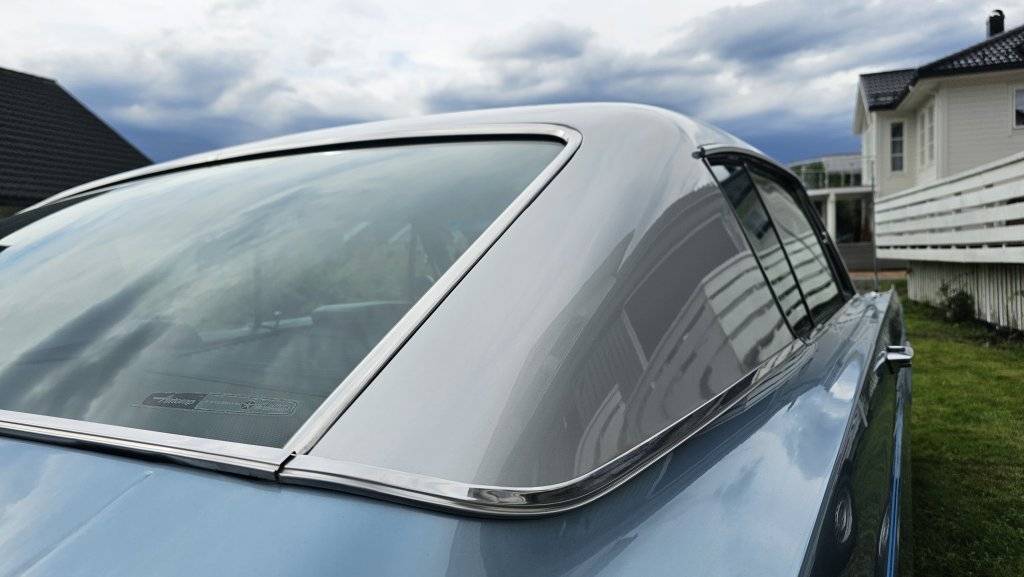

We need to install new roof rail seals and I would like to get some pointers to get it right.
Is the rubber seal supposed to be glued in place and if so, where do we apply the glue - on the whole lenght of the rail or spots in certain places?
We have two new seals (came with the car) but no istallation guide or how-to info. If we are to use glue we wanna make sure we get it right on the first try.
The seals are designed to be installed "dry". They "roll into place" and stay there, due to one "lip" on the top side of things. No sealer required, but some like a dab of an adhesive at the corners or ends. To me, rather than the old weatherstrip cement (ole Yeller 3M), I would suggest some high-heat silicone sealer (as used on engines as it is a bit "more bodied" than normal silicone) for an extra bit of sealing integrity. Just a thin bead, though, on the middle of the wide part of the metal the weatherstrip rolls into.
With the inside lip in place, then "roll" the upper part into its place. Quite easy when you get the hang of it.
Get the rubber out of the container and lay it out in the sun to heat up and "un-kink" for a few hours. Then compare it to what's on the car to see if it's "for the car". IF it did not come with the pins at the ends, carefully remove the existing pins and reuse them.
Please keep us updated on your progress,
CBODY67
CBODY67

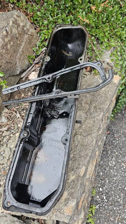

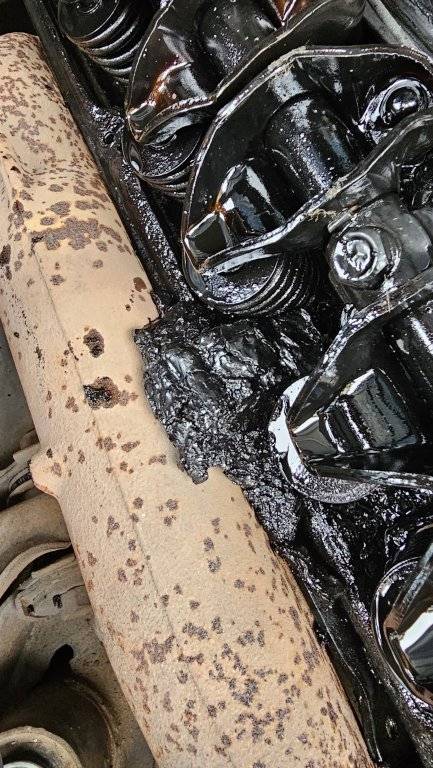

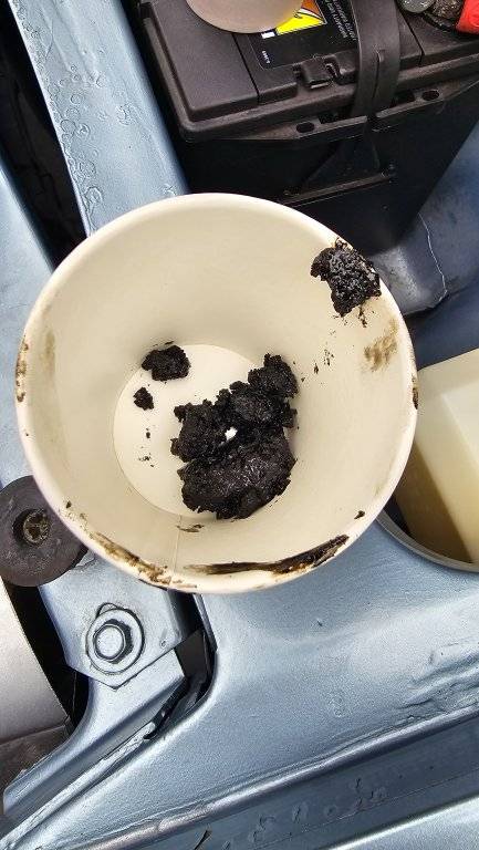

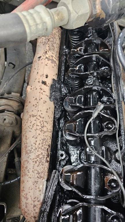

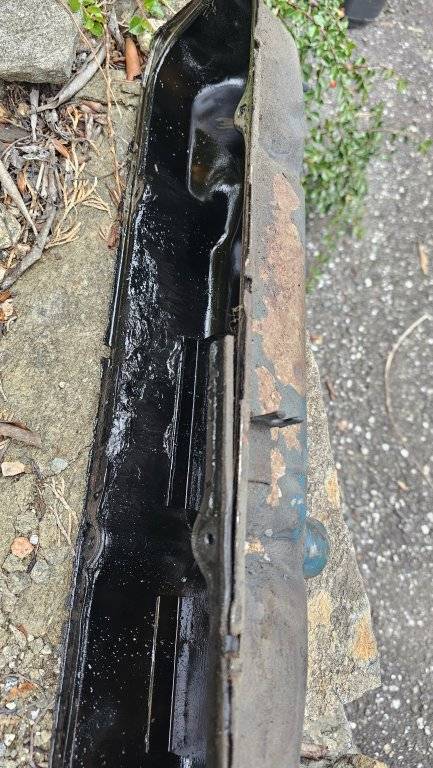

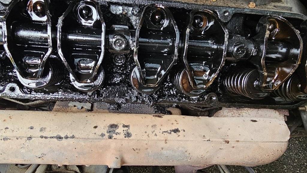

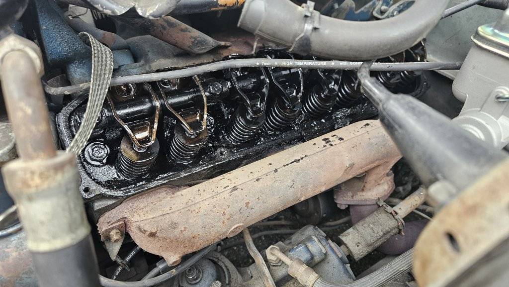

Took off the valve covers yesterday to replace the old leaking gaskets. Well as you can see it's been a while since last time anyone was in there! The pcv valve hose was cracked and has probably been so for a while and the gaskets were brittle and totally shot.
Gonna put 1/4 of a quart of ATF fluid in the engine and run it abit before changing the oil to get more crap out of it. The car has hardly been used since who knows when, probably some 30-40 years ago and will surely be a lot happier when we put more miles on it.
We also converted the ignition to an electronic kit and installed new plugs and wires. Put the ECU box behind the headlights to the right of the ac radiator for max cooling and away from the engine heat.
Little by little this old girl is coming back to it's former glory.

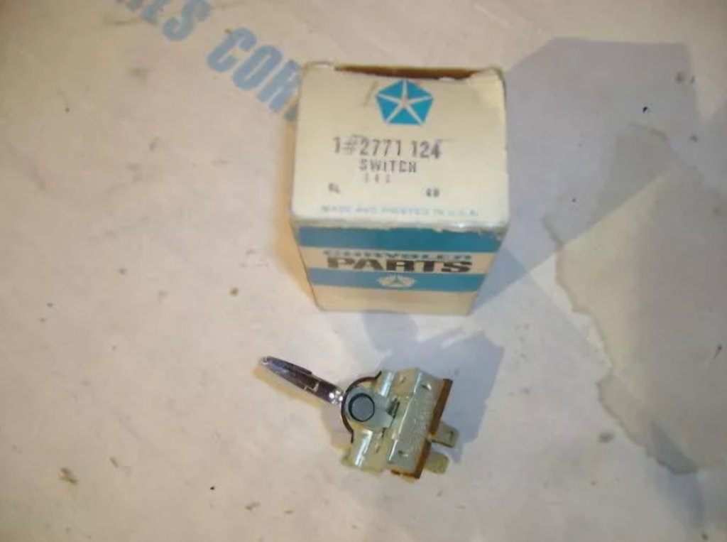

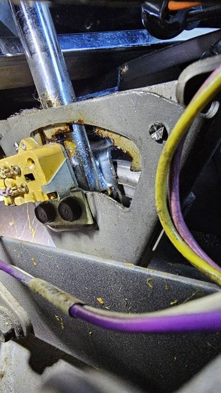

Looking for the following parts:
-Reverse light switch for the trans.
-Flasher switch.
Both are defect and needs replacing. I have seen flasher switches on eBay but checking with you guys too.
