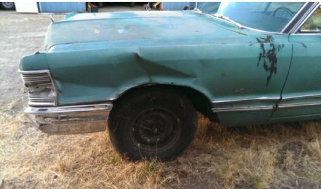

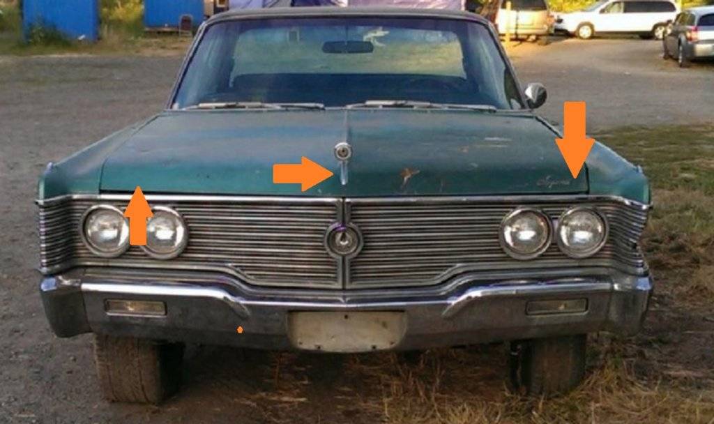

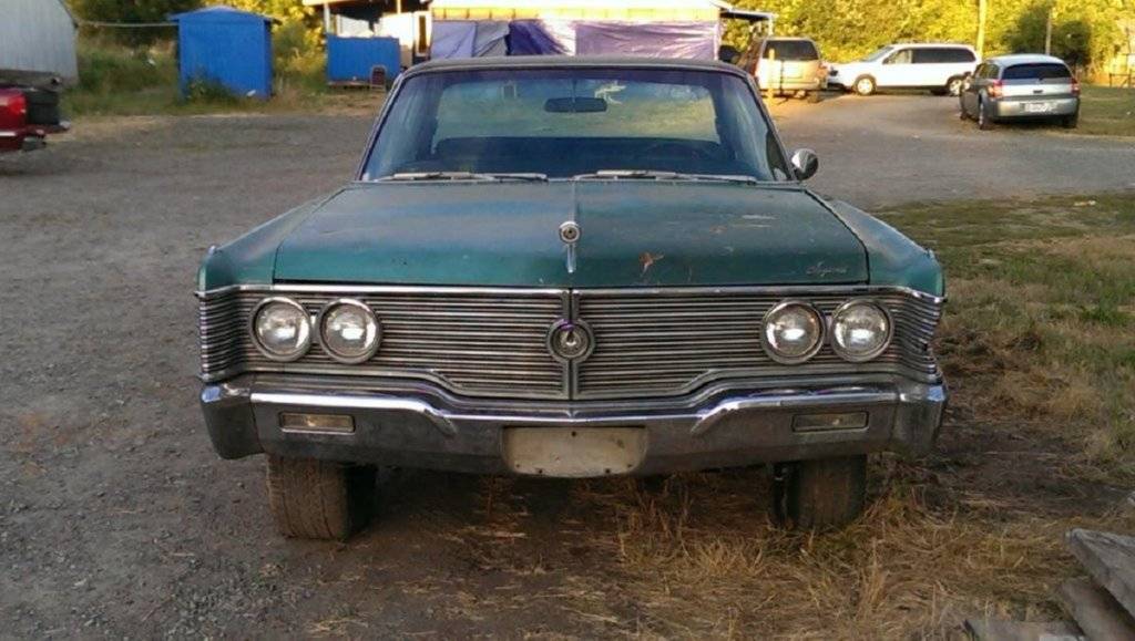

Other than fender, which trim parts do I need. whole grille or is it sectioned somehow just for the parking light/turn signal area on driver side?
Any help, as best you can tell, what's needed and/or if you have it please advise. THanks in advance.

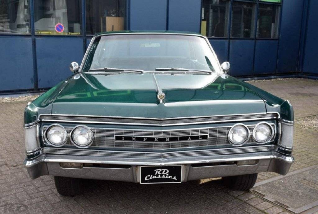

I’m guessing that hood is from a ‘67 now that I look at it closer. Different color, hood ornament and it also doesn’t appear to fit to the grille very well so I think you’ll need a hood.
a hood too ... now that's a twist. i noticed the color thing from the beginning.
BUT,
I thought the hoods were the same 67 to 68 -- the latter with NO ornament (somebody added that OR it was some obscure option in '68?), no front lower edge stainless trim, but WITH the "Imperial" badge and stamping midline curving down at front end.
I would have been surprised if the sheet metal part of the hood was different from one year to the next too. I was just thinking that whatever damaged the front end might have rendered the original hood easier to replace then repair and a ‘67 was found first.
67 & 68 hoods have the SAME part # 2859773
the 68 did not have the ornament on top of the hood
here's what I have for the left side:
2932203 upper fender rear
2932205 lower fender rear
2786127 grille extension (cornering lamp)
3004277 hood molding
& what I don't:
2932201 Left fender front molding
& what I don't:
