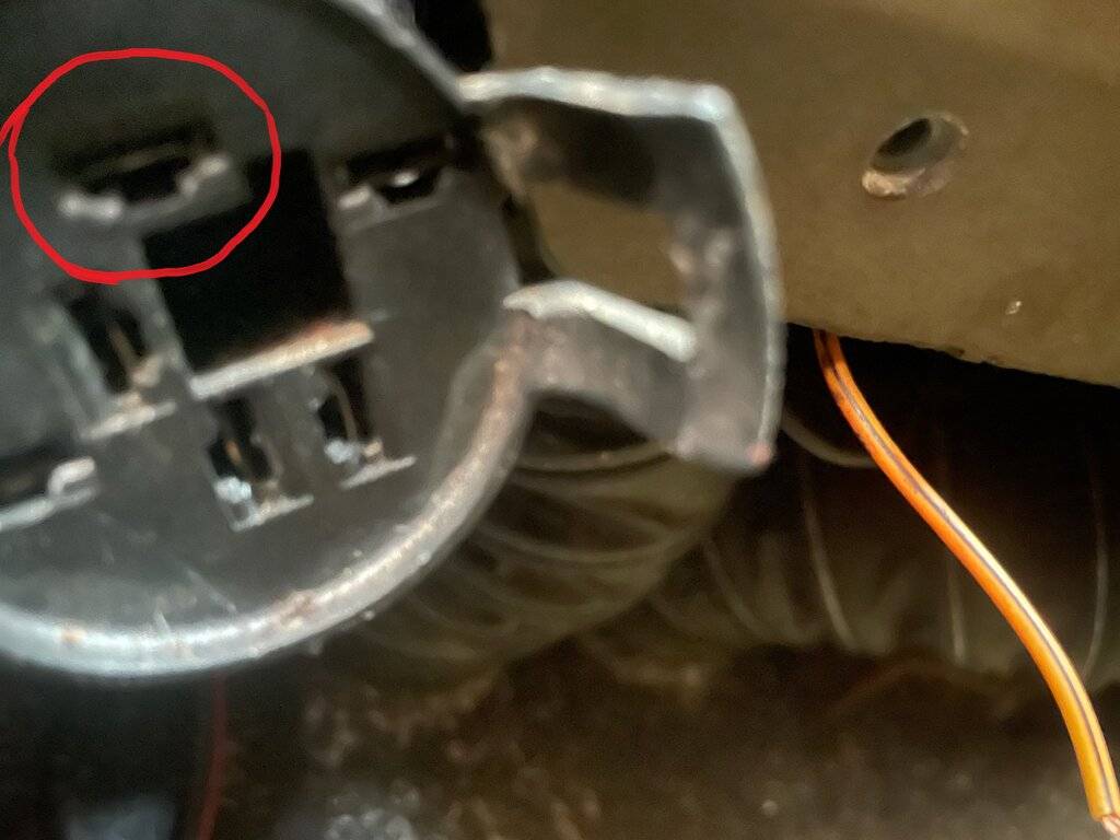

On a side note, i discovered why the interior and map/trunk lights did not work... the brown wire on the ignition switch is broken. How do you get the clip out of the plastic end connector so i can rewire it? Do they make a special tool for removing?
Still haven't figured out how to remove the broken terminal from the ignition switch connector.... any help would be appreciated.
