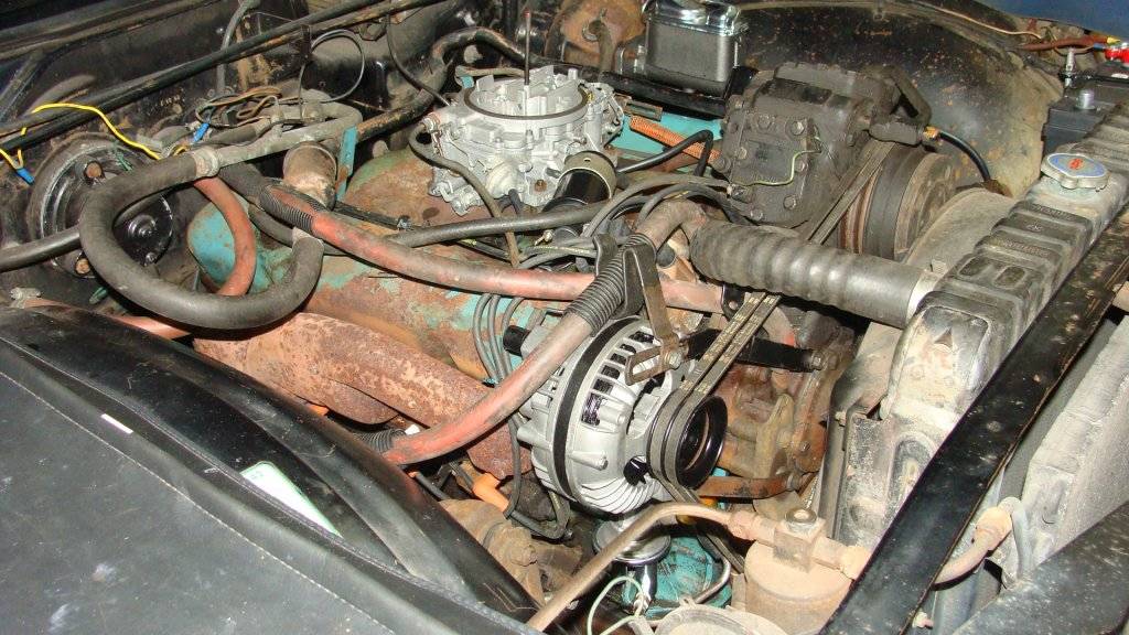

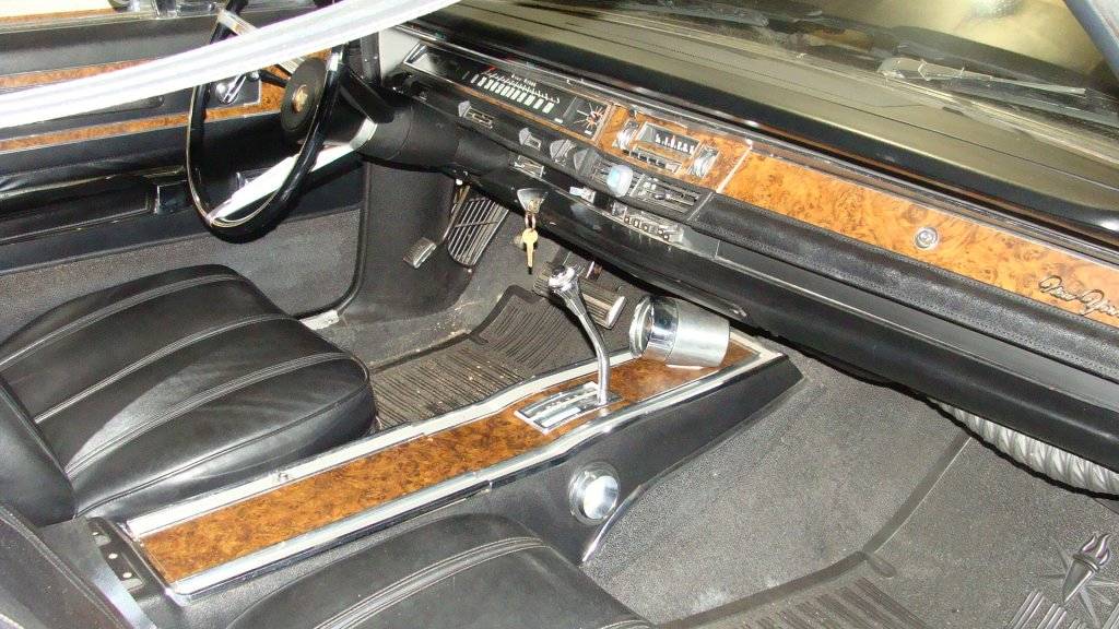

Just the housing. You can swap your key cylinder.Thanks everyone, I didn't see any wire issues, could I just wrap over the harness portion which is already wrapped just to be safe?, I'll buy an ignition switch, Do I need the whole switch or just the housing and put the key cylinder back in, Been way too many years since I've replaced a switch, is there a small pin that has too come out. John, I'll replace the ballast resistor
But before going under the dash, as I and others suggested you can test for power from the switch to ballast resistor and coil under the hood.
I rather open the harness and inspect for any breaks or chafing then wrap it up.
Not that hard but yes time consuming yet worth saving a call to the fire dept.
