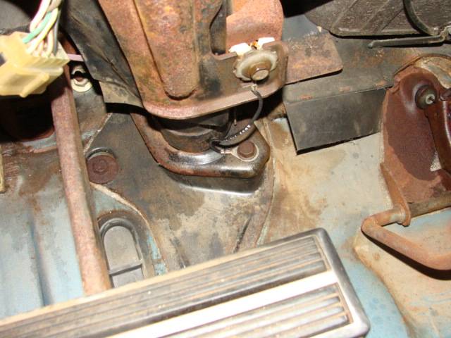

Sep 13, 2024 #1 G GOLDMYN Senior Member Joined Nov 23, 2013 Messages 1,897 Reaction score 2,536 Location Chilton Wi I'm attaching the small black ground wire, is this the right location? There wasn't any and no indication of prior attachment. I appreciate your time.
Sep 13, 2024 #2 4 413 Senior Member Joined Jan 28, 2019 Messages 2,518 Reaction score 2,922 Location NW USA Wrong place. There are two studs side by side near the dash. It goes from one of those stud and nuts then to the bolt that holds the column mounting bracket to the column.
