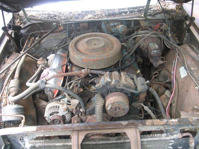

Thanks guys for the words of encouragement. Here's a pic of the engine bay:

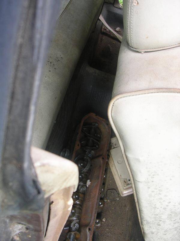

Other original rocker on floor behind the front seat:

That's one of those odd 383 air cleaners with no snout we were talking about a few weeks ago.
That's an unsilenced air cleaner .. draws air around the bottom. Base is smaller than the top and has appox 1" gap all around
Standard equip on 1968-69 340, 383 and 440 4-Barrel (except very early 68)
Did they come on any C bodies also?

Adian, what I can tell you from my 25 years of experience of MoPar collecting and restoring is this.
If you can afford to restore this car, you should. Don't hesitate, buy it. It is very rare and desirable, rarer than V code Sport Fury GT's etc. It is the "holy grail" of MoPar police cars.
Having said that, of course rare does not always translate into desirability or a substantial return on your investment. But by buying this car, at a minimum you are joining a VERY small group of owners of these cars specifically. And once this car is restored it will be very desirable to a much larger group of MoPar collectors, in my humble opinion.
What I can verify from the photo is this. You are looking at a PK21K two door, fleet ordered Police Pursuit. With special ordered code 99 paint, brown and white which is unusual. K code Police only 440 Commando 360 HP engine. It has the original unsilenced air cleaner. There are holes on the drivers side fire wall for a siren. Which are similar to VSP location. lt Should have HD 727 torque-flight. It shouldn't have Sure-Grip, most police cars did not, for safety and traction reasons. Look at the diff. or the build sheet to verify. It has extra body welds for structural reinforcement , unibody and subframe for extra stiffness (done by hand) e.g. = hand built car to some extent. Roof reinforcement plate for lights/siren. Battery heat shield. Spot light (obviously). etc. Correct 1968 B-Body steering wheel in black. Which was a Pursuit only build item, a B-body wheel in a C-body. The 69 Polara CHP cars got a white steering wheel, the 69 Fury Pursuit got it in black.
Possible options are tow package goodies, which may be on the build sheet. And special police only high speed tires.
This car clearly served in some capacity which is unknown at the moment. It's up to you to find the agency in which it served.
The VSP (most likely choice) put the unit numbers on every car that served whether it was a patrol car, scales car, or Pursuit car. Look on the fire wall next to the A/C box, in the glove compartment and the rear deck lid near the drivers side hinge for a number in yellow or white paint pen for a THREE digit number, painted by hand.

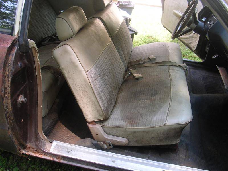

Try and save the floor mat, be very careful if you remove it, NOT to rip it. It may be very brittle. These are impossible to find in good condition. Try and save it at all costs.
The car is worth it, totally rare and cool. You'll be the ONLY one on your block to have one! :)
I have seen cars that are in far worse condition restored. The fire wall looks good, which is a good sign. Hopefully the frame rails are ok too.
If you need help, let me know. I have contacts in the VSP if your car served with them.
Good luck and remember the early bird gets the worm! If you don't buy it soon, someone will and soon.

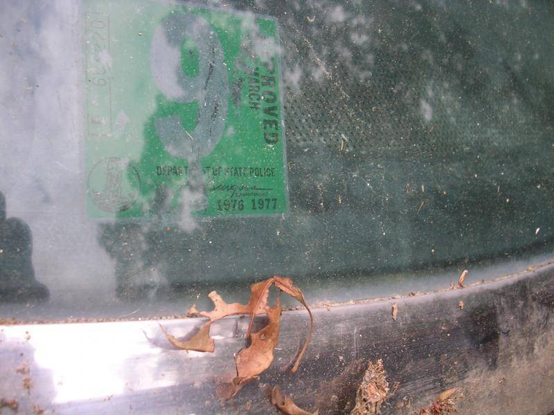

Thanks man, great advice. Car has Department of StatePolice sticker in the front window, dated 1976-1977, so the car has been offthe road a long long time (thus leading to the deterioration I would imagine -being stored outside does not help, it has been there some time as nogrowth under the car). I hope to seal the deal over the next few days (the owner has to move some vehicels out of the way etc.), if I lose out, and I really hope I don't, at least I've given it a shot. That is all I cansay. I realize it is a MASSIVE project but I intend to preserve it as is -not part out, modify, hot rod etc. etc. Just a plain jane stout machine.

The green sticker in the window is a state safety inspection sticker. "Approved March" and 1975 cut out means that the car was last inspected in March 1975. The nine means that it was due for inspection again in September, but for reasons unknown, never made it back to the inspection station. Probably, the car was sold at auction after the county emblems were removed. The civilian who bought it probably had it inspected, was driving it, and then parked the car. Most likely, it's been sitting since 1975, waiting for help. Go Aidan!
Below is a link to a report made before Virginia changed over from semi-annual to annual inspection. The report is dated 1978.
http://www.virginiadot.org/vtrc/main/online_reports/pdf/78-r36.pdf
