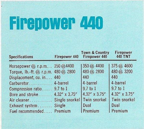

On Chryslers or across the board? Was the dual exhaust an option on 71 350 hp models
I was referring to Chryslers. There might have been some T code Dodge or Plymouth fleet vehicle that could have had duals, but I am not so familiar with those vehicles (with special order options more likely) that I would never say never. But for regular production models, I would wager that no C bodies with T code engines had duals standard from the factory for 1971 and later. U code 440s certainly did, however.

Was your blue one a 440 standard T code, or a 383HP (4 bbl)? I wasn't aware you had an option for a second pipe with the T code engine, but it surely wasn't standard on any of those that I am aware of. The 383-4 engine did have them standard I believe.
That could be one of the reasons the T code was down rated from 350 to 335 horse for '71.
My understanding is that the primary reason for the downrating of the T engine was due mainly to a drop in compression ratio, not the exhaust system per se. Except for the Town & Country in 1970, all the other T engines had single exhaust standard for both 1970 and 1971 in the Chrysler line at least.

Yes, compression ratio for '70 was 9.7:1, and '71 was 9.5:1. Would drop to 8.2:1 in '72.
