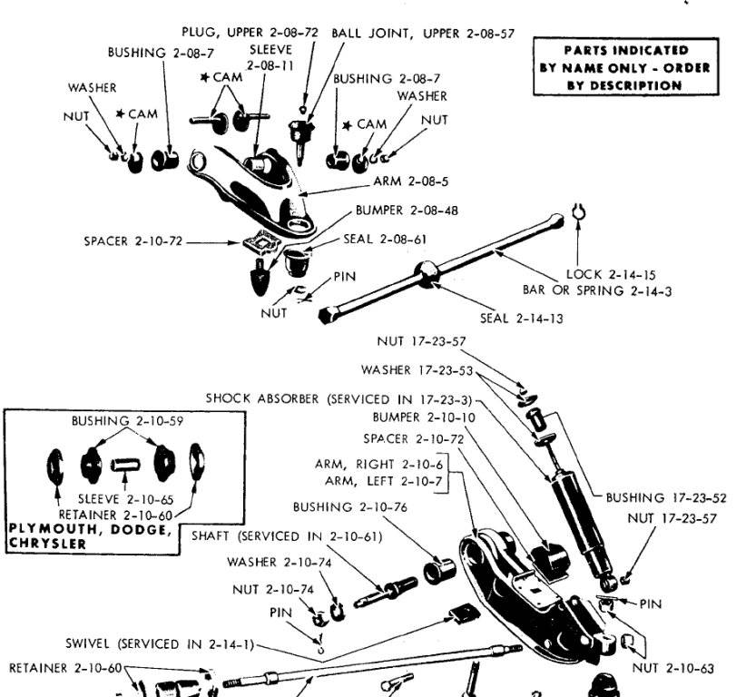

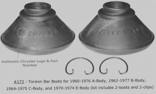

From my experience, and the OEM parts books, the boots had a locking clip on the minor diameter. Why would somebody simply not replace the boots? Who knows but time and hassle are probably reasons.Did the car roll of the assembly line with any clamps on the rubber balloon seal? I don't think so... so why would anyone need a clamp?
There should be tons of NOS & Re-pop seals around, why not just replace them?
