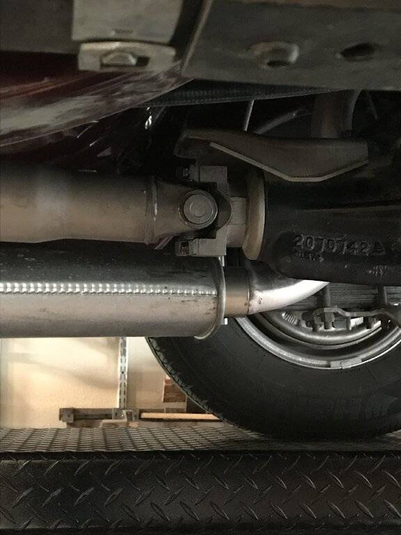

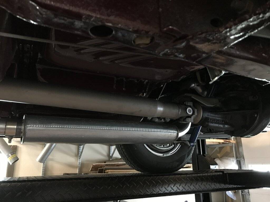

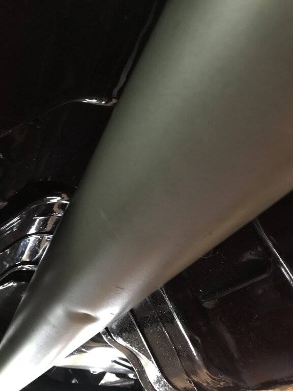

I get a similar vibration in my ‘68 Polara. Every thing is smooth until I hit 80 mph and then I get a resonance/ vibration. I rotated my tires around and it did not change. Next step is probably the drive shaft. Earlier this summer It seemed like the vibration was happening at around 70, one of my new U-joints after just 2,000 miles was shot. I was getting about 1/16 - 1/8” of radial play. I replaced it and was good until somewhere between 80 & 85. I do have a few gravel road dings in my drive shaft so maybe it is a little off balance. It seems my angles are fine.
Bone stock as well. Am looking forward to what you May find.
View attachment 385973 View attachment 385974 View attachment 385975
Fixed my vibration issue. It was my drive shaft being a little bent. They re-straightend and re-balanced it. Vibration totally went away and is even much quieter at cruising speed.
Drive Line Angle will drive you crazy
