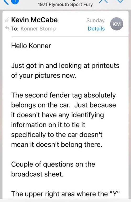

So here's the verdict. I bought the car not knowing anything about what a Fury was, what parts were important or even how important fender tags are. It originally had another tag on the cowl that I was told by multiple "Mopar experts" didn't belong to the car so I wrote it off as that and threw it in a box of parts. Recently I took the time to contact Kevin McCabe (Past Chrysler Historic) and send off detailed pictures of my car, the broadcast and fender tags as well as vin info.
Chalking it up to a misprint. The car came with a few things not fully listed on the broadcast like the executive interior and the tag as well. He's currently working on finding out what the "Remarks" codes stand for.

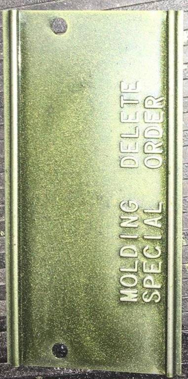

The second build tag is usually a "comments" tag. It can be used for a variety of things. It can designate "Special Paint, Special Order, Special Handling, Sales Promotion Vehicle, Auto Show Vehicle", and on and on. It can also be used if the number of displayed options exceeds the space on the first tag. As a comments tag it usually means there was something out of the ordinary about the vehicle. Entirely possible that your car could have been ordered without the side moldings. (In most cases no information would be displayed in the stripe section or the delete code would be displayed). "Delete" is an option if the dealer knows how to properly enter the "delete" code, some were a lot better at this than others. I did not see any reference to a second tag in your first post. It is important to include things like that as that can often give a clue to non-standard vehicle features. I don't have any good explanation as to why your comment tag was left blank, could be that plant used a blank tag as an alert to non-standard features rather that listing what the feature was. Anyway, good luck with your car.

I think it's very apparent by the BS and the tag that it DID come with V5X. Remember, moldings are more than just the V5X. There are other moldings on the car that could have been deleted. Don't automatically assume the V5X moldings were deleted when all other evidence tells you differently. Check your line 9 MOLDINGS against the car. Maybe one of them was deleted. Check your broadcast sheet against other similar cars and see how they code. Maybe your car is missing an M code.

Because the tag is attached after BIW and before other items are attached, painted, trimmed, I’d pursue the idea that one of the standard M code moldings was deleted. Sourcing the additional codes in REMARKS can’t hurt your research.
The difficulty will be determine if the molding was deleted by the factory or during the restoration. Or, possibly, if a molding deleted by the factory was added during the restoration.

Check your BS M codes against the moldings on the car. Either something was or wasn’t deleted. If the moldings are there, something wasn’t deleted or someone replaced a deleted molding, in which case you may never know what was deleted.
There are only so many options available to this mystery.
