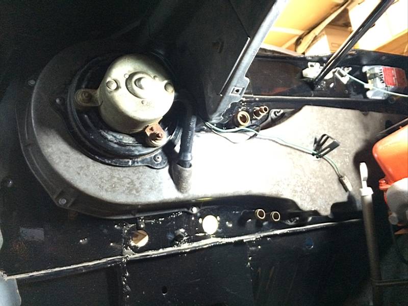

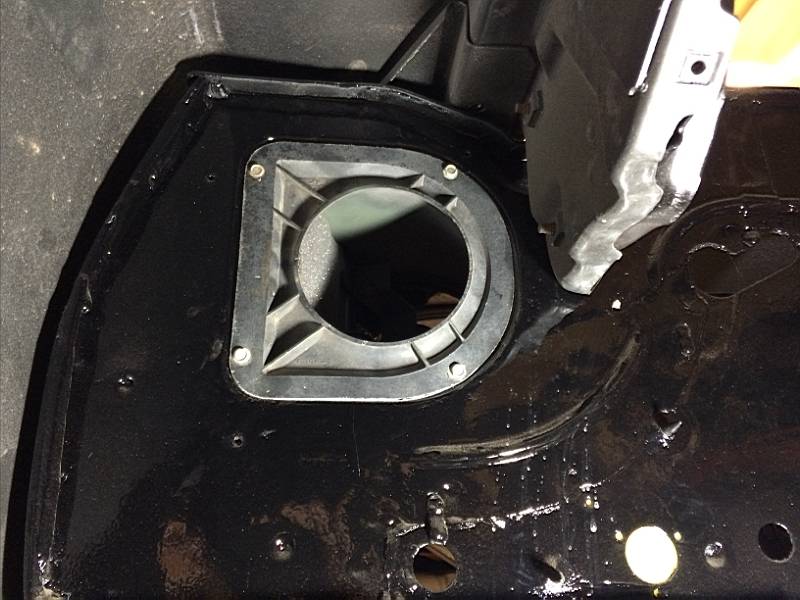

Well the damn core started leaking last year just when I had new seats and floor mat installed. I bypassed the core for that summer but I feel that now the time has come to fix it.
I have the engine out so there is plenty of space in the engine bay. Can I remove the core through that black plastic box which is installed on the firewall? Previous owner has apparently already removed the bolts and nuts but it is still held firmly with the factory goop/sealant-whatever.

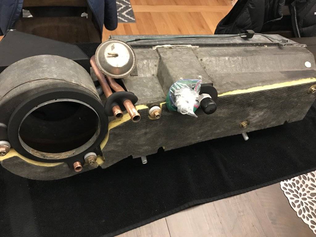

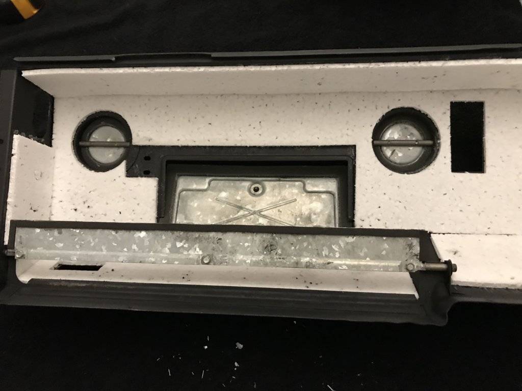

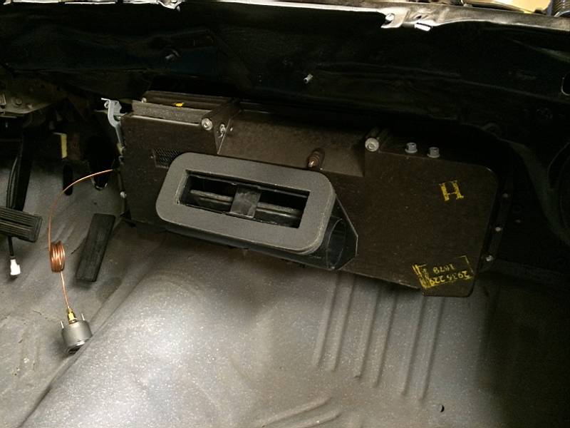

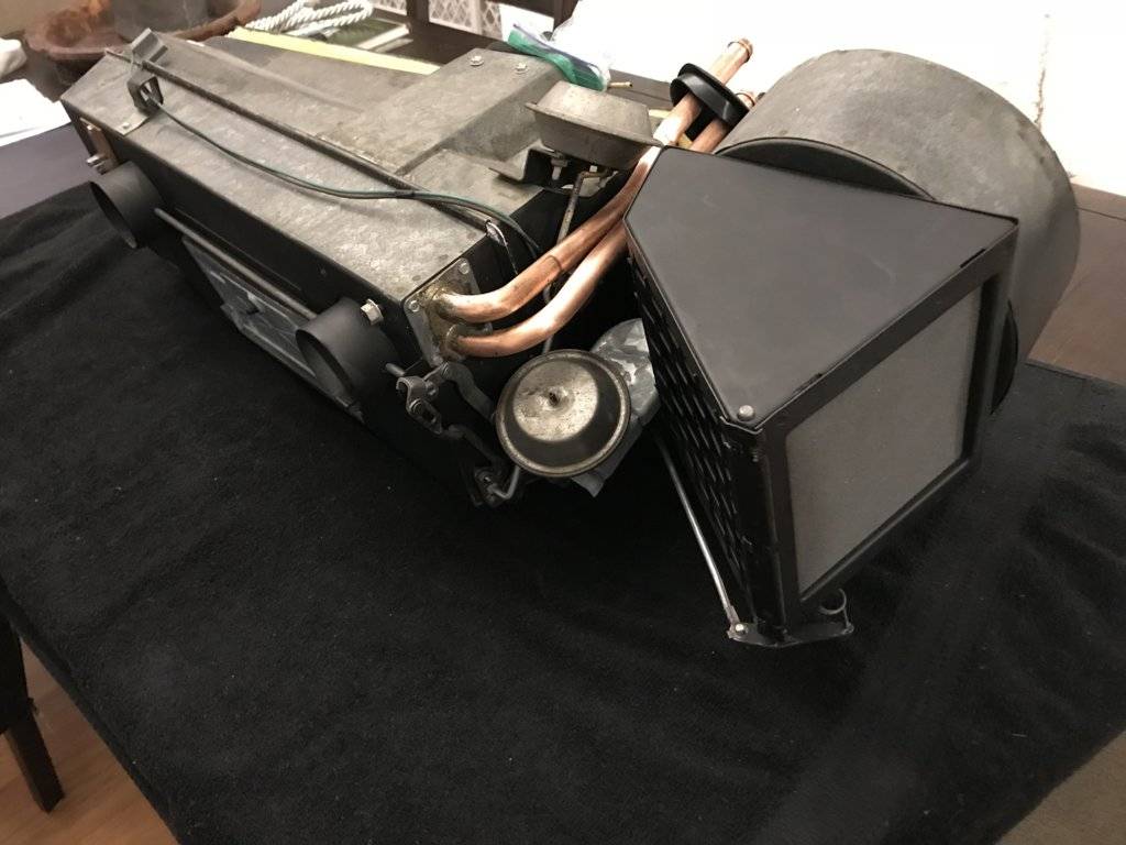

The heater core assemb. comes out from under the dash. Not as bad as it sounds Disconnect the duct hoses and the lower heat distribution duct. Disconnect vac hoses at the main connector by the floor and vent actuator. Unplug the blower resistor and remove the rear support brace. You didn't specify if it has A/C. If it does discharge Freon and remove A/C hoses. Put rubber caps over heater core connections. Be sure all heater box nuts are removed. If you have a console remove it. Roll your carpet till it clears the dash assemb. Pull the heater assemb straight back, when the heater box studs clear rotate the assemb so the core faces the floor and wiggle and slide it out. While you have it out replace the foam as it will help w/ heater efficiency and overall function. Detroit Muscle Technologies sells the replacement foam as a kit. If you have any problems PM me.
And have fun!
Thanks for the info and pics! Ok, so I am in for very miserable weekend :D

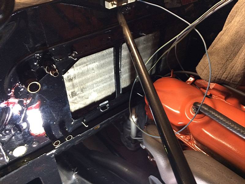

Hmm, what is behind that black box which is attached to the firewall in the engine bay?
post a pic please
There is no need to remover the cover on the engine side, you will need to remove the nuts holding the cover to the inside unit. Just remove the seven nuts you can see, there are some screws under the fender that also hold the cover on but not needed to remove the inside unit.

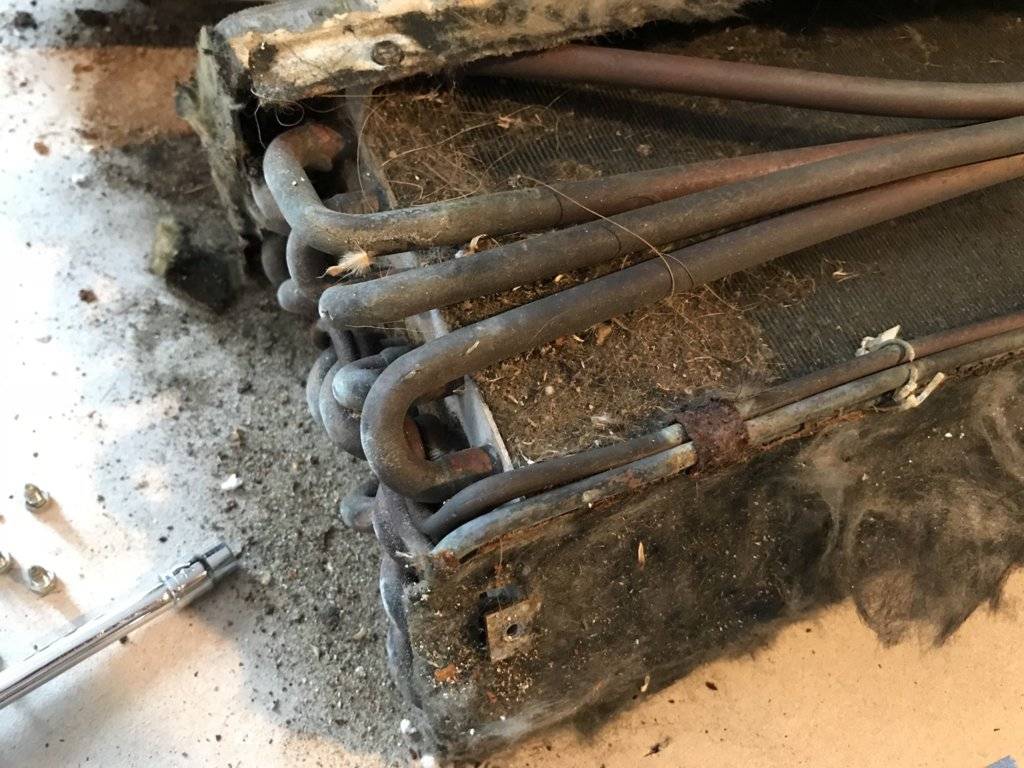

Be careful when you remove the A/C unit as the hose connections sometimes seize and you can damage the evaporator trying to get them loose. Some times a little heat will be necessary to get them loose. If the compressor has been off , odds are both the evaporator and condenser are full of degraded oil, not to mention metal chips from the burned out compressor. Be sure to have both of them cleaned before trying to reactivate the A/C.

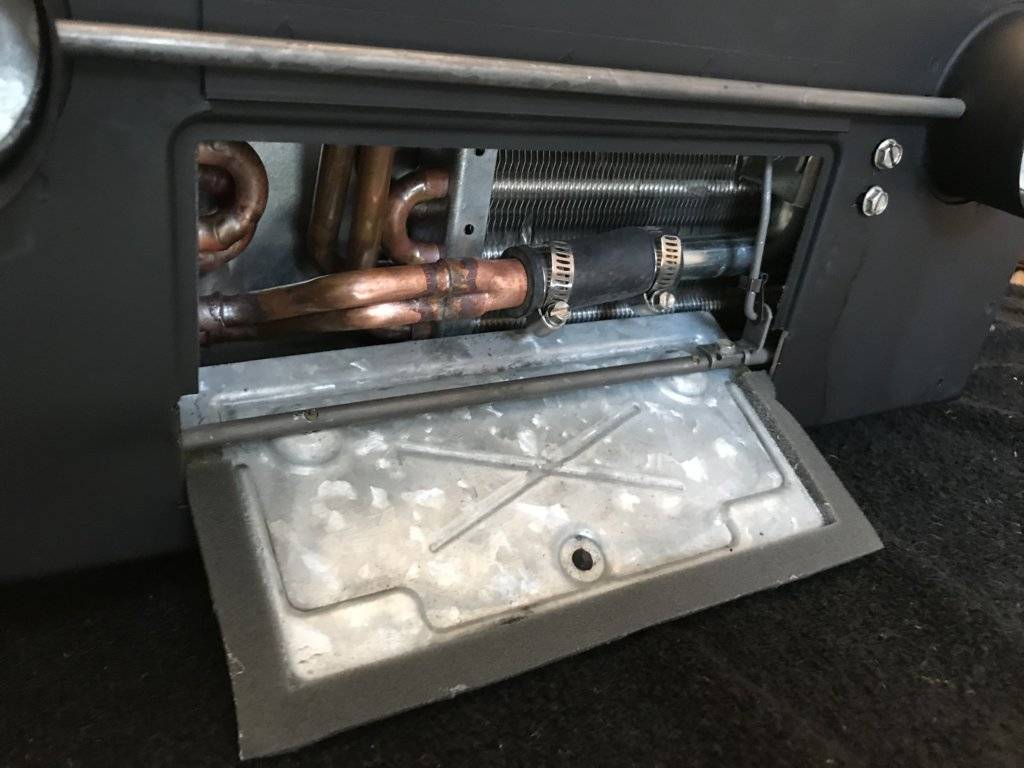

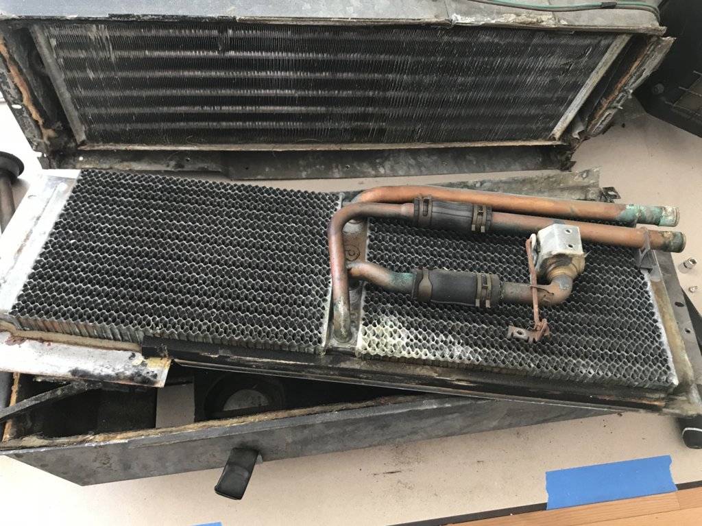

Once you have the unit out, note the two small hose connections to the branch fitting for the heater core. Often the reason these cores leak is because the small hose section has failed. Given that it is a pain to pull the system apart, I would probably still change the core unless it appears to be in pristine condition, not worth the hassle to pull the thing back apart.

Thanks for the pics and explanations!

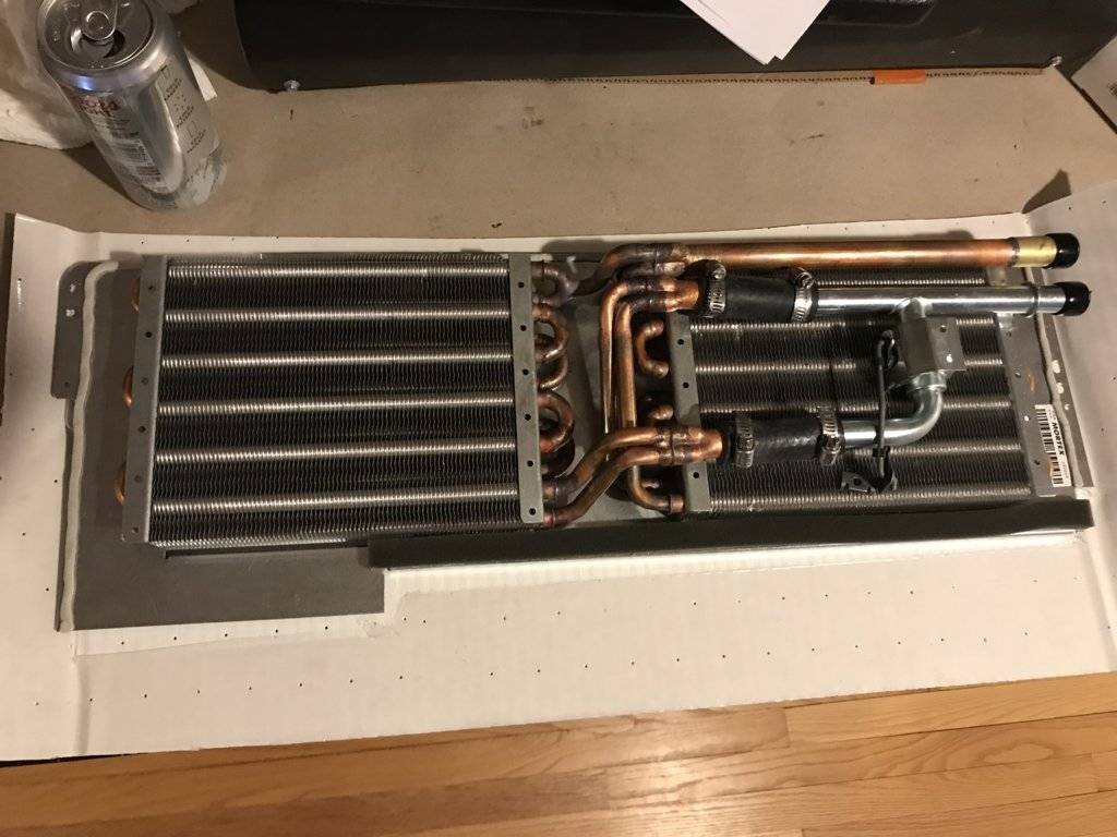

In the photos above (with rodent droppings etc.) looks like the heater core is the old v-cell type.
Get it recored at a radiator shop with a modern tube and fin style core. Regardless of core style, solder gets brittle over time and degrades. Best thing you can do is just keep your coolant fresh and you could kick this job down the road a ways if a leak hasn't happened yet. Check for electrolysis in the coolant and flush if more than 0.3 volt.
As for the firewall side plastic housing, it looks like this is just a bolt on duct and doesn't house anything.

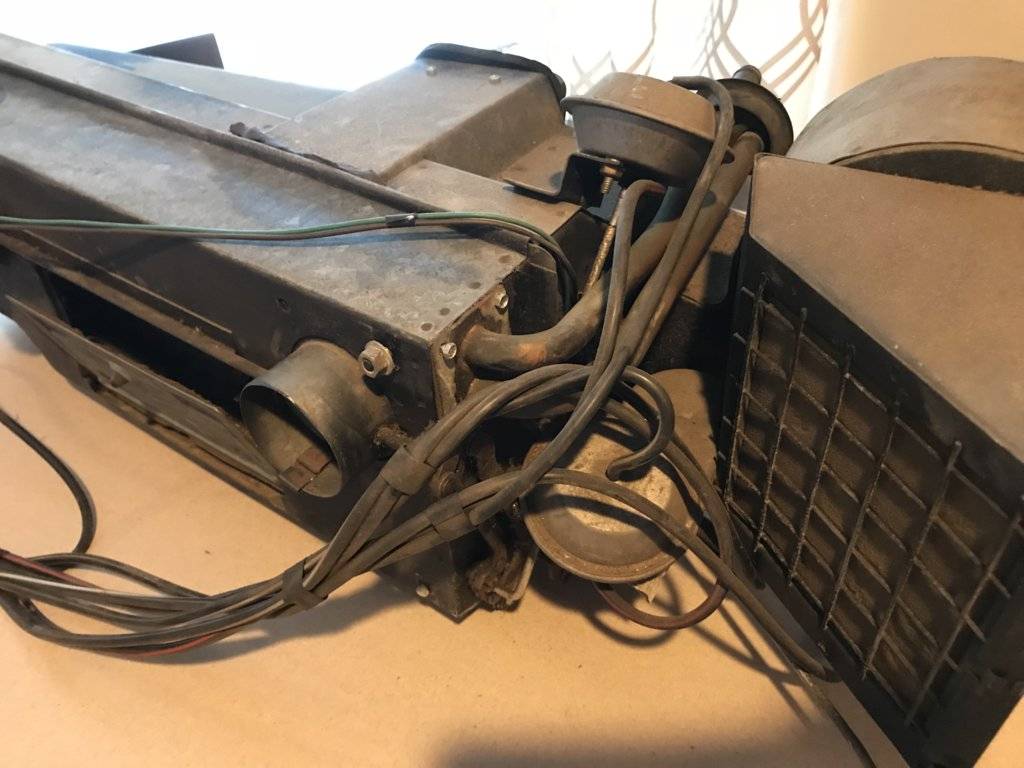

For my ‘65 Fury wagon (above photos) was begging for a new heater core so I went with Classic Auto Air.
