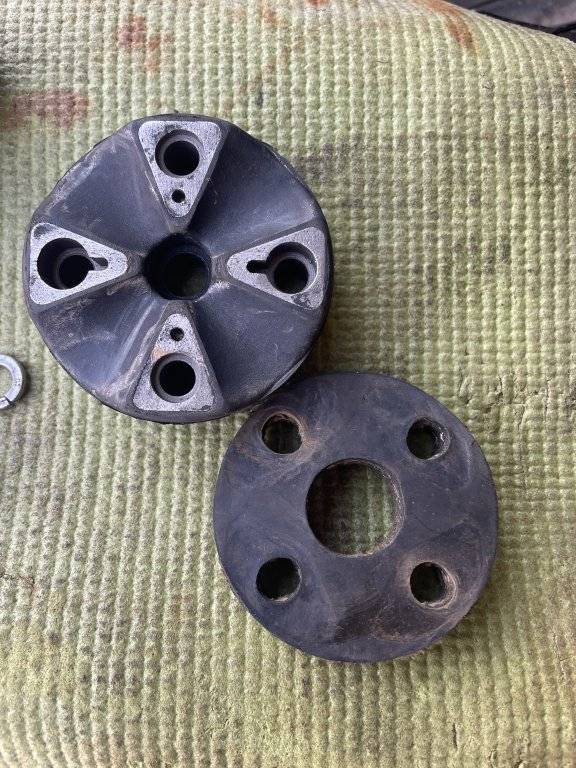

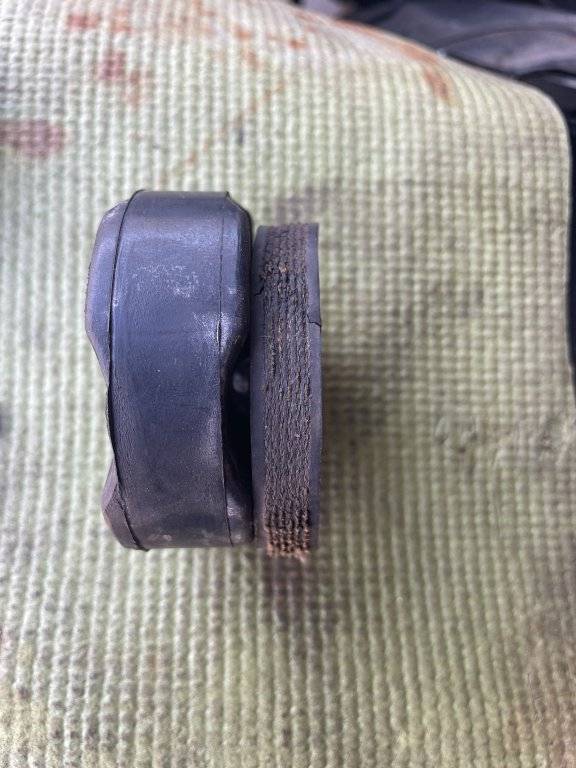

What @Big_John said, PLUS, unless the extra thinner rubber piece is the "universal" one you refer to, that extra donut of rubber is NOT required, as far as I know.

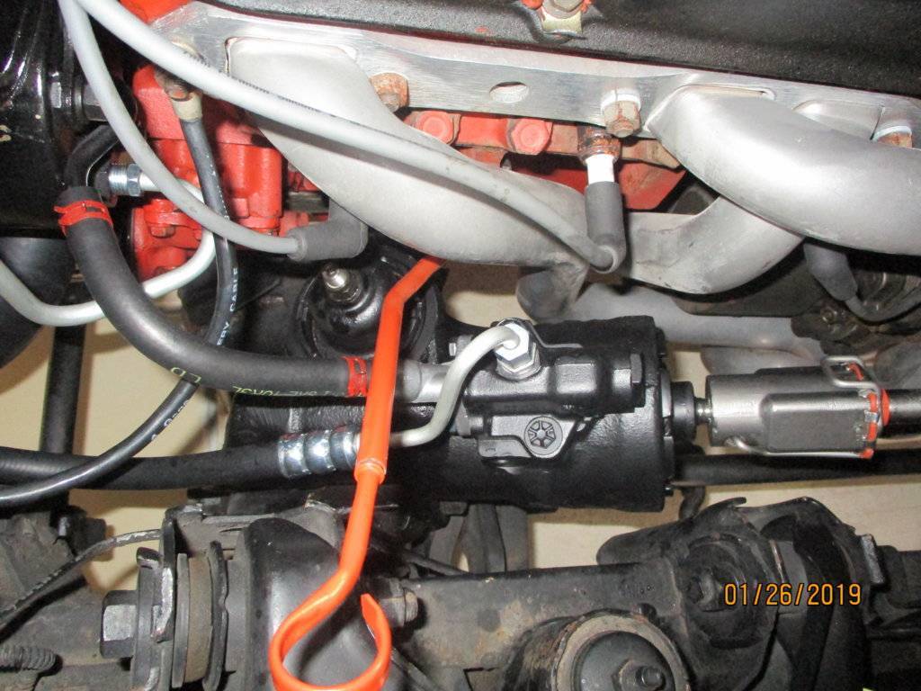

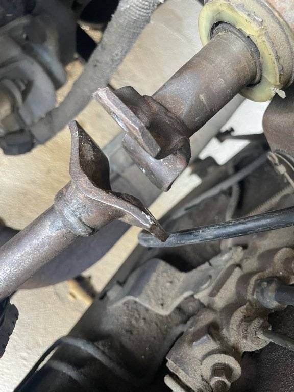

Let's go back to your other thread. See the coupler? That HAS to be repaired. It should slide in. (see red arrow). The way it sits right now, it looks like it's coming apart and needs to be repaired/reassembled.
The car is not safe to drive until your repair it AND I think that will solve your problem by letting the stub slide into the coupler. It's very easy to tale off. Just knock out the split pin (circled) and pull it off the steering box. Since there's a red gasket on the coupler, and not the original black, I'd say it's been apart and not assembled correctly.
