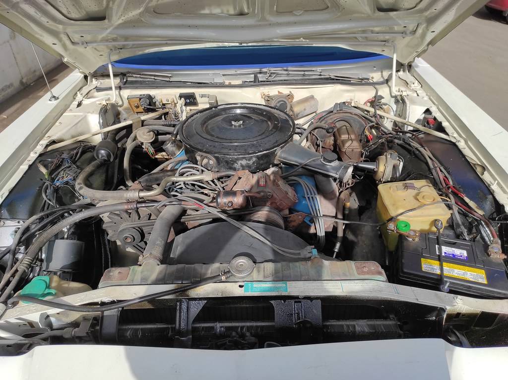

Well, I found out that it is pretty hard to troubleshoot this stuff alone :) anyway, first I noticed that metering rod is stuck/not moving, but that was an easy fix - unscrewed it and released, screwed back. now it moves freely. Somehow I rode fine several times and didn't notice anything (though MPG was not the best I guess with metering rod stuck). However main thing I noticed - I don't see any fuel squirting. It is wrong, correct? What shall I check next? disconnect fuel filter and check if there is fuel there? Try to crank engine and verify fuel pump is pumping fuel to the floor/bucket (with fuel line disconnected from filter)?

Does it still run? Should be squirting fuel from the center nozzles. Looks like a broken accelerator pump. Can be replaced but have to open up the carb for that.

Your idle will probably come up on its own when the carburetor is set right. Get a vacuum gauge to set the mixture screws by, then use tach to set idle speed. If it ran fine, and is all of the sudden running rich, the first thing I would check is if the floats move freely and still float. Then if the needle and seat seals. Do this before you turn any adjustment screws. I don't know about a thermoquad, but there are some Ford carburetors I have ran without a top on them to determine if the fuel bowl was overflowing/ needle and seat not sealing.
