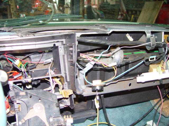

The metal top pries right up with the tip of a small screwdriver. Please, dont scratch it.
You need to drop the steering column for the front panels first.
Along the bottom are screws that secure the bottoms of all the plastic front panels which then pop out.
PLEASE buy the Factory Service Manual. It was INVALUABLE the first time I took my identical to yours 76 dash apart. It has instructions to disassemble the dash.
It's an extremely tedious dashboard to take apart. Without the illustrations in the manual, I guarantee you will break something that costs as much as the manual.

No. I meant you have to unbolt the steering column from the dash frame and drop it down.
