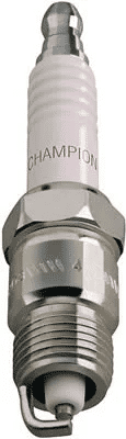

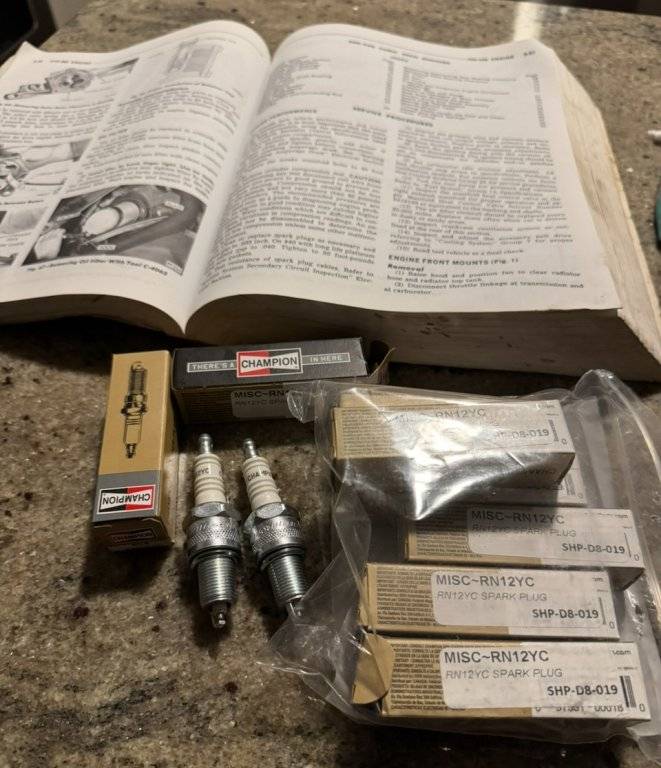

Alright, I've resorted to asking.
I pulled the plugs on my New Yorker because it's been running a little rough. They were very dirty and generally looked old and worn. So I decided time to get more.
Here's the problem, the plugged I pulled is a shorty plug. I'm all my days I have never worked on a vehicle that had shorties. So, did some online looking, seemed that the general consensus for plug for this car are Champion RN12YC. Got them ordered and they arrived today. They are not short style.
I have a frigging manual and I cannot find a mention of a part number for plugs, took me forever to find the gap as it's just randomly inserted into the engine performance section.
Does this car need shorty plugs, if it does which ones do I need?! Or are these Champions good to go (once gapped of course)?
Thank you in advance.

These guys have covered what plug you need, but I feel like it should be stressed NOT to use these plugs. They are for a small block (318, 360 etc.) and will damage the tops of the pistons in a big block (400, 440 etc.)

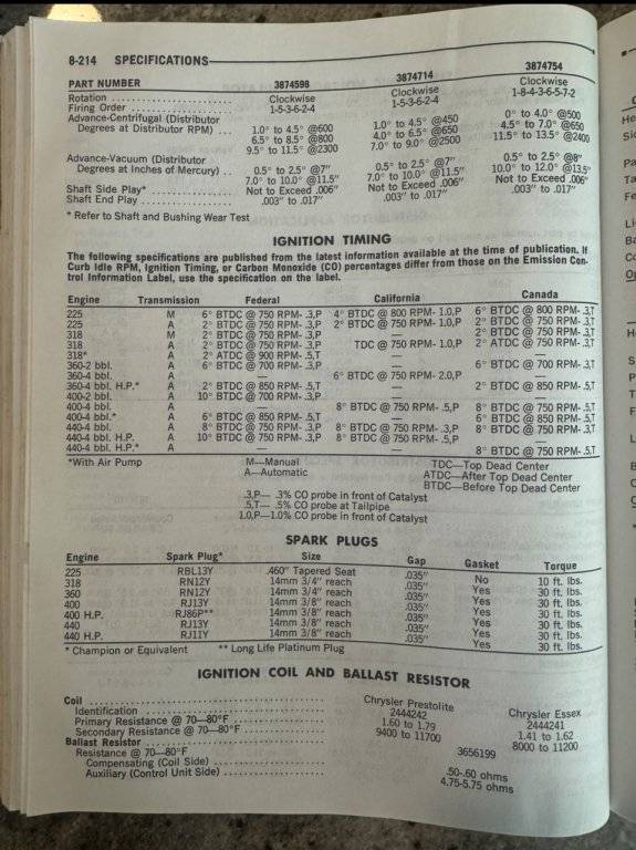

It should be in the back of the Chassis manual electrical section, under "specifications". I don't have a '76 manual to tell you the exact page. I believe there are two manuals for your car, one "chassis" and one "body".

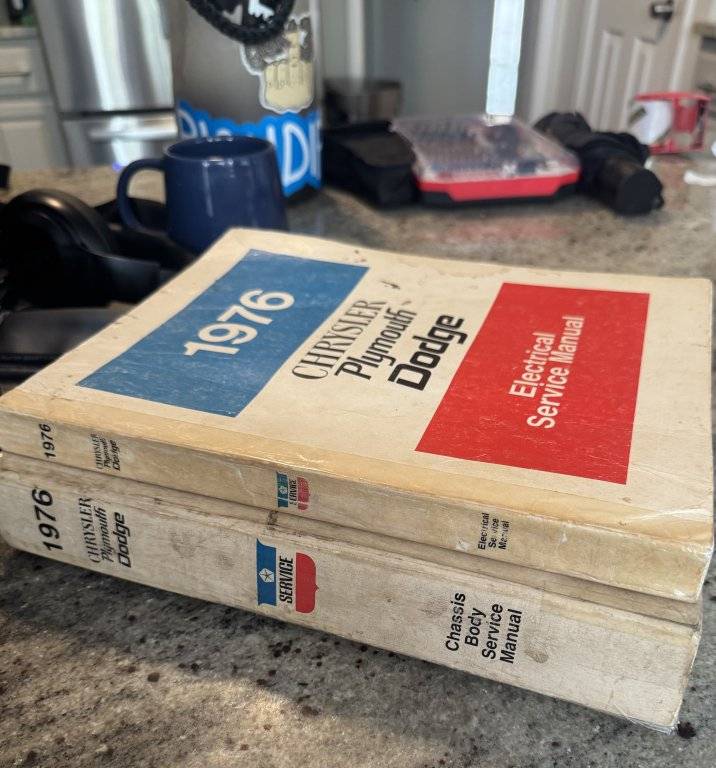

My manual is actually two books, one for body and mechanical, the other is for electrical.
I remember that now.
I think they went to 2 books in 1971. Those were chassis and body. Somewhere along the way, they went to body and electrical. Maybe 1975?
The 1978 Chrysler FSM I bought at a swap meet is one book as the 1970 FSM is (for my DH43N0D), my '66 and '67 Chrysler books are. Same format in all of them. Spark plugs listed in the "Ignition" section. Perhaps, in some years, they made two books as some dealers didn't need "everything"? FWIW

Thanks guys. That is what I figured, didn't think it would be these. I will order the shorter reach plugs. Appreciate the item numbers.
I had previously looked at the "Ignition" section, but found no specs. But, just now looked the "Specifications" sections, and lo and behold there it is. ‍♂️

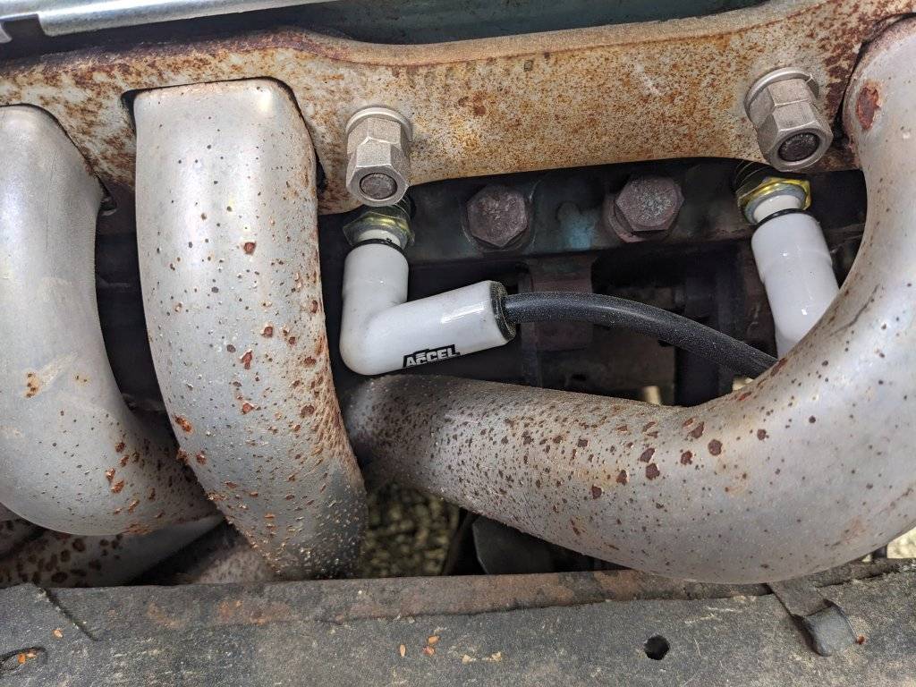

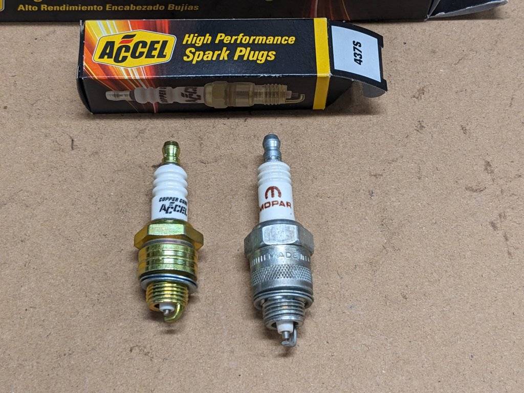

Accel still makes the short spark plug version of the J11Y/J12Y/J13Y which is #437S.
I use these on my 440 truck with headers due to pipe clearance issues with the stock plugs, and also with the Accel ceramic boot wires I have:

The format of the service manual book(s) did vary over the years. For a loose snapshot of the 60s-80 centering on rear wheel drive cars:
Early 1960s had more specific model manuals:
1971 started the "Chassis" and "Body" manuals:
The three "brands" combined in 1975, and body wiring diagrams appeared in the "Body" manual:
In 1976, things switched to the "Body Chassis" and "Electrical" manuals:
In 1980, the manuals moved to "Body Chassis Electrical" and "Engine Performance" manuals:
In 1983 it became "Chassis & Body" and "Electrical & Engine Performance" manuals:
And in 1986, a single volume for rear wheel drive cars, which was growing few, and more and varied manuals for the other vehicles, particularly front which drive, which was growing more:
By the 2000s, things were becoming more electronic, but a print manual set for the 2008 300/Charger is five separate books:
