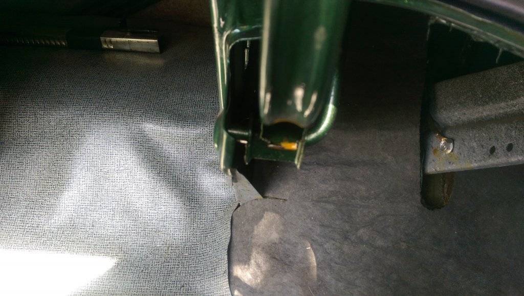

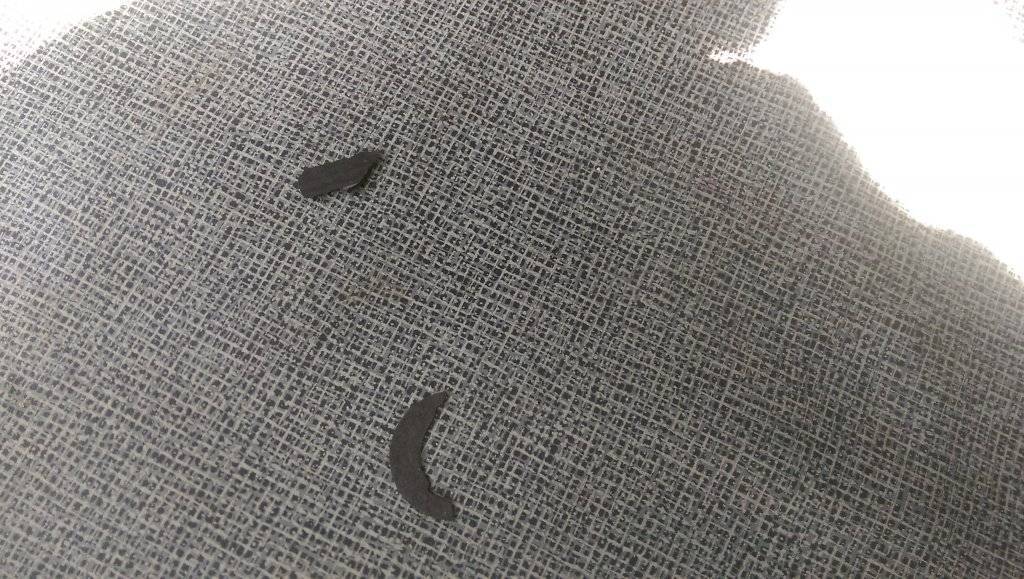

I have seen little black pieces of something on the trunk floor. See the photo below. They are not metal but resemble dried out----undercoating or insulation? I do not think they are parts of the cardboard trunk trim. Is there a connection with my first theory above? They could have dropped from any number of holes (hinge and light holes, for example)

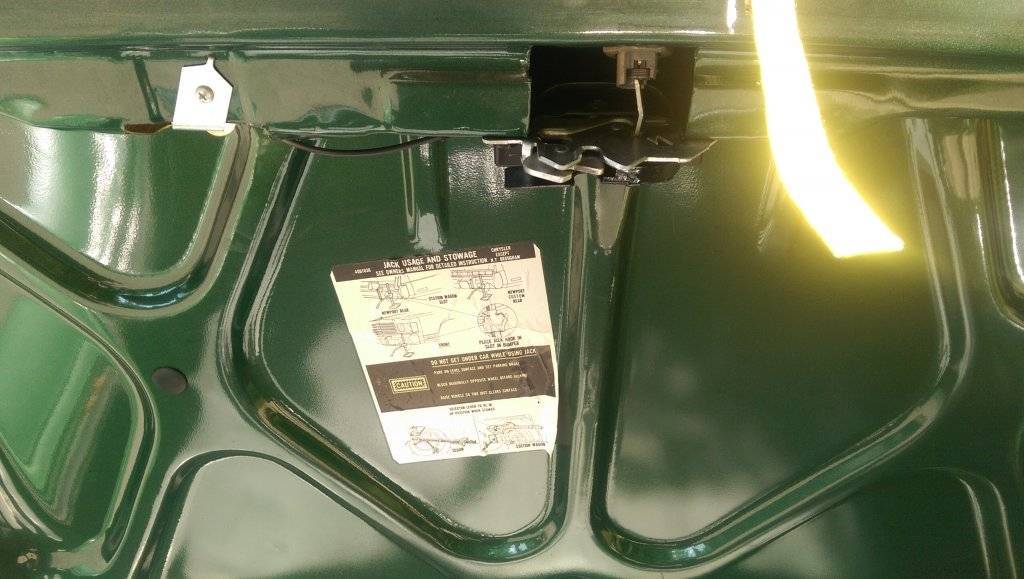

If you look at the photo of the inside trunk lid, you will see a rubber/plastic port on the left side. It comes off, and there is a hole. Did Chrysler put this in, or did some PO drill it? For undercoating?
