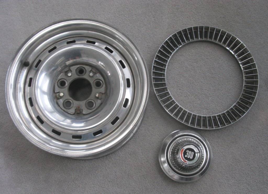

Great picture amazinblue82. Shows all the pieces on a W23 option wheel. Best thing is it shows the difference in the ID of the trim ring vs the OD of the center so you can visualize the amount of rim exposed. That visually clarifies the (non) cover the OP referred to.

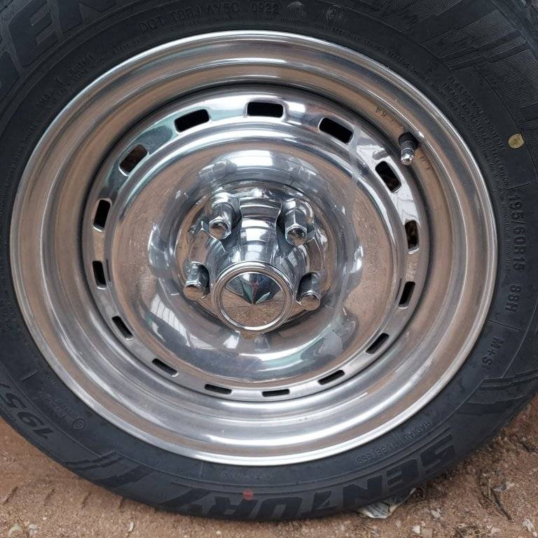

Gorgeous 300 azblackhemi ! I'm a fan of these alloy slotted wheels as my use demonstrates. I was forced to investigate different center caps because the correct aluminum ones were really beat.
