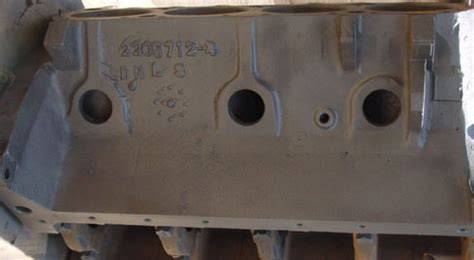

4 more on the sides of the block. Unsure about on the rear.
3 on each side of the block =6 in block
2 on the side of each head
1 on each end of each head =4 on each head
14 total on a 1968 440.
block ones are tough. There is one on each side behind the engine mount bracket.

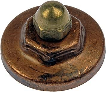

Either way, the rear head plugs and the block plugs are going to be a PITA. This style plug works well as an "in the car" fix and some boat guys use these on new builds. Look for "bronze expansion plug".
Usually about $5-6 a piece.
The rubber versions are temporary (in theory) but I've been surprised to find them in cars with years of service on them. Not recommending them, but they will work and sometimes you do what you gotta do.

Well, those bronze plugs do work. You'll have to buy them by size rather than application and don't expect the local O'AdvanceZone to carry them. Like I say, some boat guys swear by them and use them in new builds, so they will work nicely.
