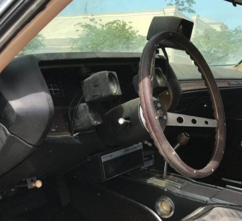

Are those gauges? The car looks nice in that color.
