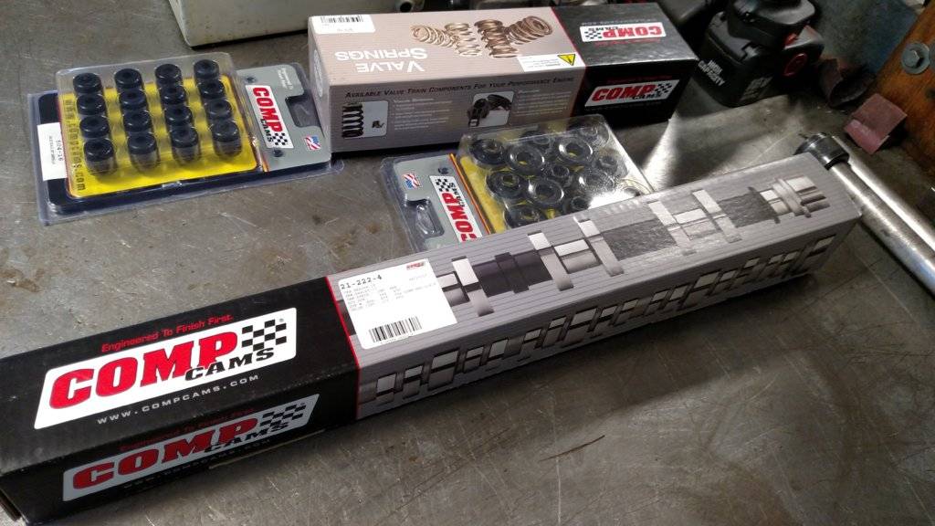

The rebuild of my 440 called for a set of KB hypereutectic pistons too. I purchased this cam and complete kit. It's a dual pattern cam (a little more duration on the exhaust than on the intake) and specs out a little bigger than the Mopar HP cam. The engine has terrific throttle response and excellent vacuum. Unlike Bob, I can stop more than once. . .

Rip, I've heard from solid people that have had issues/failures with Comp cams/lifters. Thoughts? Comments? Concerns? I have the 274H I plan on using for personal build, also Tim has the same in his 71 New Yorker and has had great success too.
Wyatt: The old gentleman who built my engine mostly builds race engines - almost exclusively. He uses only Comp cams. I had the same concerns as you, but I feel he knows cams better than anyone I know. . . So, I went with his advice and recommendations.

So what you are saying is you went with your engine builders recommendations and are happy with the result?
