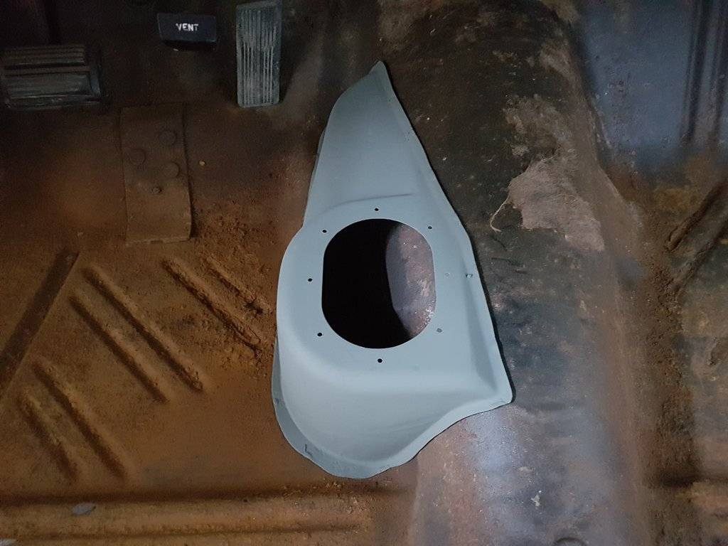

Well, two weeks ago I got an E-bay link from a fellow board member regarding my quest for a C-body 4spd hump. Last week it arrived in the mail :)
As some of you already know, I had bought a 318 3spd Suburban from 1971 less drivetrain and I have every intention of converting it into a 4spd.
I testfitted the hump and marked the cutting area. I think I might just replace a few areas of the floorpan while everything is out...
I will try and update the progress in this thread

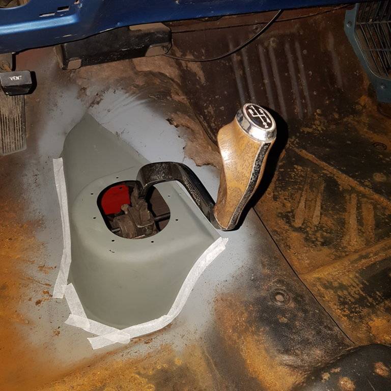

Well, it has been a while. I had some time off to spend with my daughter, who was born on January 26 :-)
This weekend I cut the floor and test fitted both hump and shifter. The latter I testfitted to check clearance with the dash. It still needs to go up a bit but everything looks good. According to the pics I saw of the 71 Polara I should have no problem. I am using a used 71-up B-body bench seat shifter with the box at the original mounting location on the tailshaft. I could have used a 70 B-body bench seat shifter but since the car is a late 71, it didn't seem to be 'correct' haha
