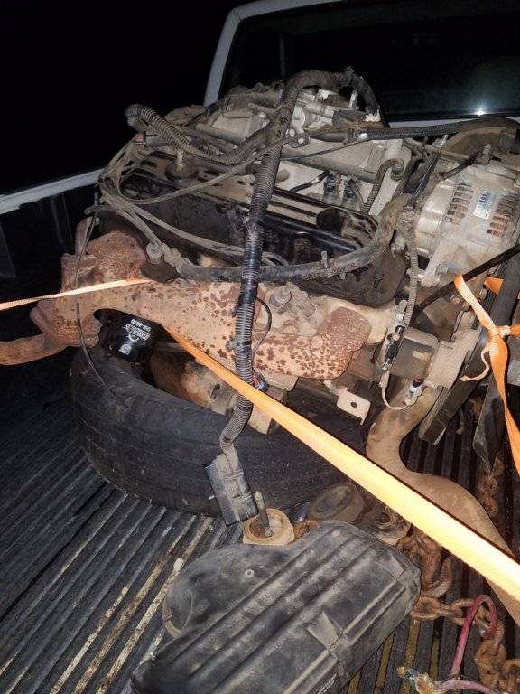

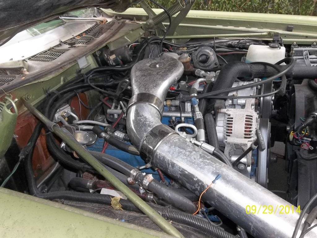

Hey everyone,
So I've given it a bit of thought about what to do with my Fury-sans engine, originally considering a big block, then an LA 360 (which is what it had) but I think since I'll mostly be cruising with it, I'm going to do a 5.9 with a 46rh. Now, full disclosure, I've never done this before, so I'm creating this thread to mostly ask for help if I need it.
I will be switching to carb and an older style ignition(I may even use the stock one with the car, it looks recently replaced). I do intend to use the PATC kit for the automatic operation of the 46rh. I will be keeping the serpentine drive for the accessories, and might go to an electric fan, but I'll see if I can't get the old style fan to work. I'm keeping the compressor, because I might can junkyard an AC system for this thing later on.
It's a HD drum car(which I'll unfortunately have to use for a while, can't afford to do it all at once) and it has an 8 1/4, which I don't plan to replace. I really doubt a 5.9 with a cam is going to pose it much of a threat. I'll also be using the stock lockup torque converter too, since it's probably once again not a bad selection for a warm 360. It'll have around probably .500 of lift, and probably off the shelf, but I don't know just yet since my main focus is 400 ft lbs of torque with an air gap and 600 to 650 sized carb. Suggestions welcome. I'm not replacing the heads until I can afford engine quests, it's not worth it to me to slap Chinese heads on it to take em right back off in 2500 miles.
I'm probably going to replace the gears in it with 4.10s, with limited slip if I can get it, I'd imagine a junkyard Jeep is my option here. I know the liberty came with the 8 1/4 and some Dakotas did too, so we'll see if I can use those. I'll have to find an older carrier because of the older spline count but I doubt this to be an issue. Lots of A body guys around here.
I'll probably have to shorten the driveshaft 3.5 inches from what I've read, and have to get a 46rh yoke, but that shouldn't be a problem either. Junkyard to the rescue.
If it's not apparent yet, the goal here is cheap. The car will be incrementally upgraded until I'm happy with it, how fast is determined on how my jobs look in a few years, but the focus right now is to get it driving. Then I can worry about the other stuff. It'll eventually get new suspension, springs, t bars, and front discs, and finally a respray with it's original B2, but that's a ways off yet.
I'll be posting my snail's pace progress here as I get stuff done. I'll be picking up a 360 tomorrow and a 46rh Wednesday but with the hellacious southern winter they're predicting I don't imagine much progress to be made until spring. That said, anyone have concerns or advice so far?
