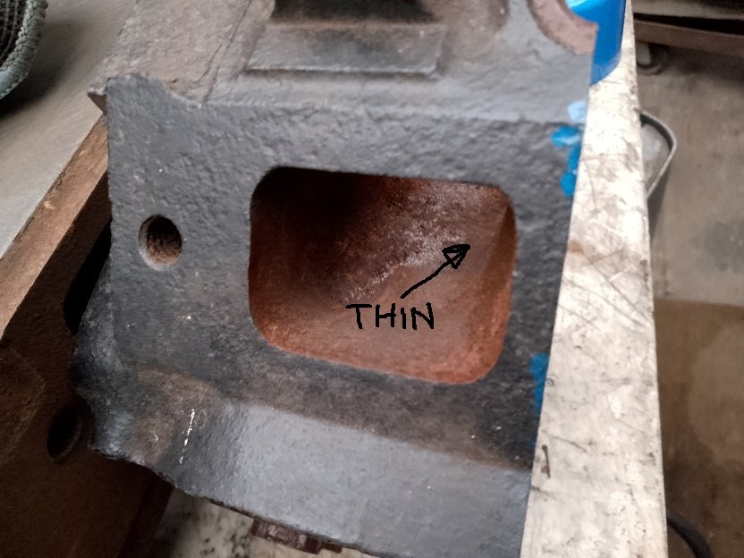

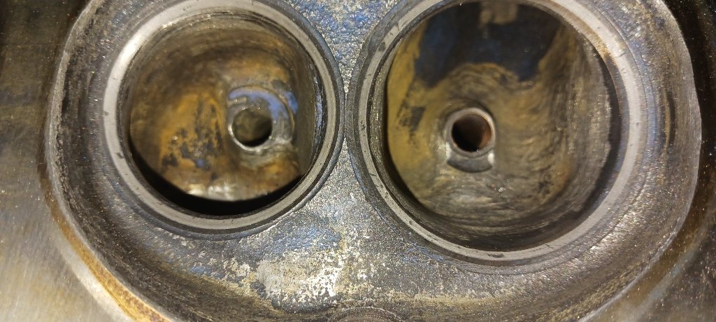

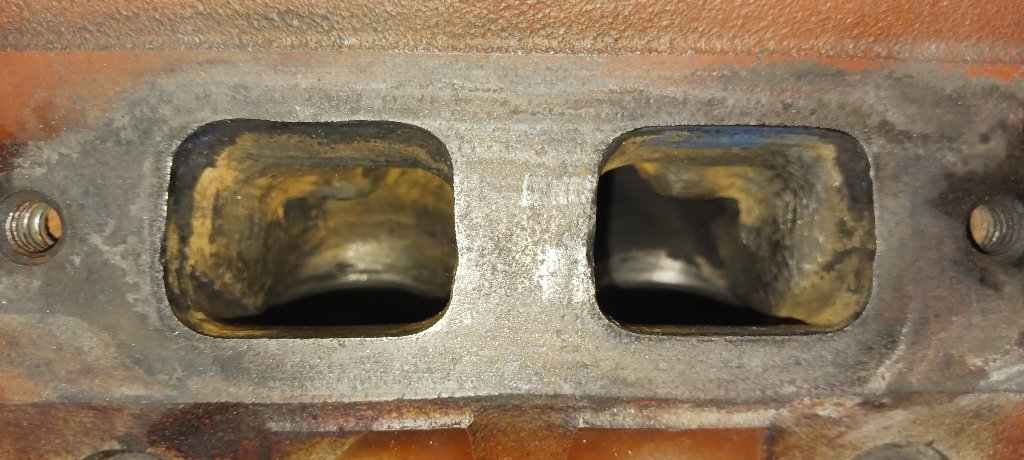

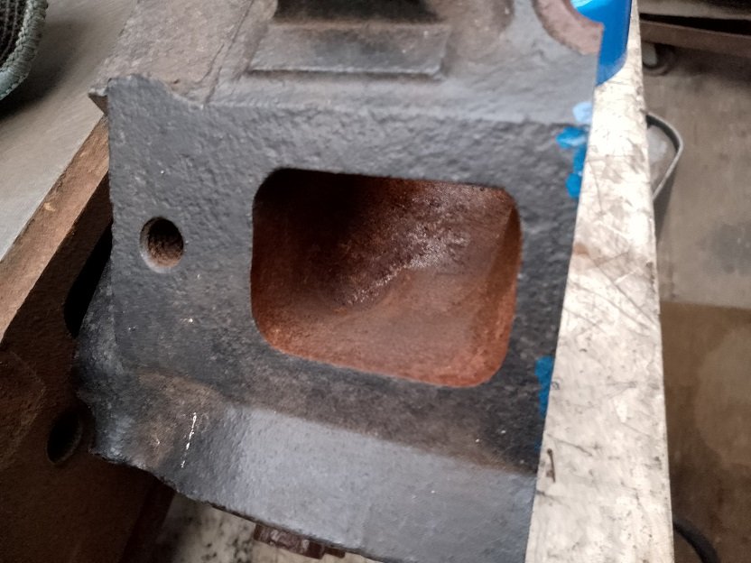

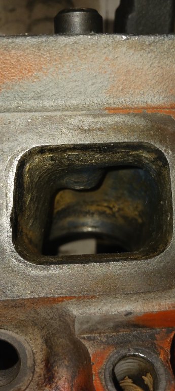

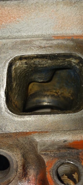

Thanks a lot John for the help and information. I am going slowly and listening to the sound of the wall as I remove material particularly in the erea you pointed out. When you tap it with a metal bar or screwdriver you can hear the sound charging as it gets thinner. This is how far I am going. (pictures) the exhaust, as you mentioned has this collapsed (picture) roof that I removed as much material as I felt brave enough to do it. Most of the reshaping and increase in area was done on the sides and bottom. It is significantly larger than stock.i will probably cc the volume after I am done just to see the numbers.

I have ported many Mopar heads and the 516 is very tricky to do.
There are deep exhaust port earlier castings and the less desirable 65/66 ones.
When you see them next too each other its very obvious indeed.

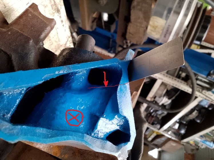

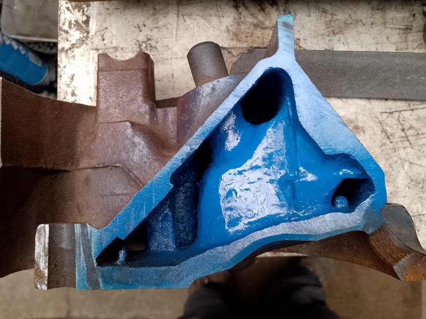

This cutaway is a low roof 66 head it broke through in several places.
if you cut the roof too deep it will go into water, same as between the valve pockets...:BangHead::BangHead::BangHead:
This one may explain better, with the ruler lined up with the port exit
The circle shows where you break through between the valve pockets
(Exhaust pocket shown, cut between the ports)
Thanks John! That really helps! I will just polish the exhaust and not going any further. It should flow much better than before. On the intake side, I got the wall towards the pushrod hole to be about almost 1/8 larger which should help make power above 5k rpm. I am installing a 239/249@.050 cam with 106 lobe separation and a tunnel ram with 2 Carter afb 500s. The 66 polara ran 13.8s with a 430 lift cam shifting at 5k rpm. Hopping to go faster next summer.

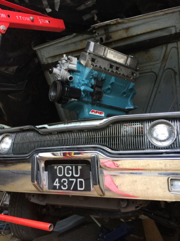

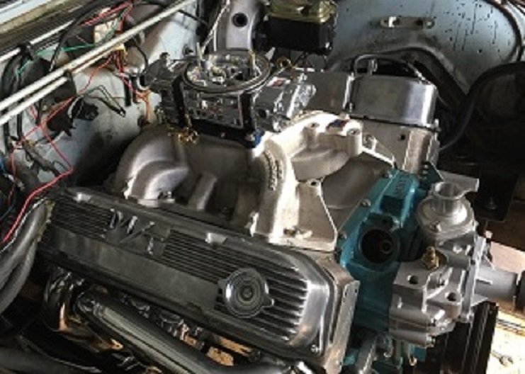

We cheated with our Polara...
512ci with Edelbrock heads and a 550 Crower roller camshaft.
13.20 in Drive, if you run a 12.99 or faster you need a rollcage and other safety stuff
