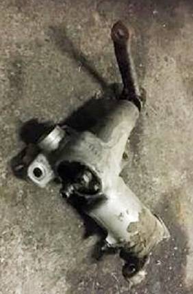

My -56 Chrysler's steering box is way gone when it comes to adjusting but I've been offerd one from a -55 Dodge to use the stuff inside, so I wonder if anyone here knows if the mechanics inside would fit?
This is the (cover broken) one from the -55 Dodge:

This may be a good question for the folks over at Firm Feel.
I took a look at my '55-'58 parts book and it appears that 55-56 Plymouth and Dodge are different from '55-'56 Chrysler and DeSoto.
