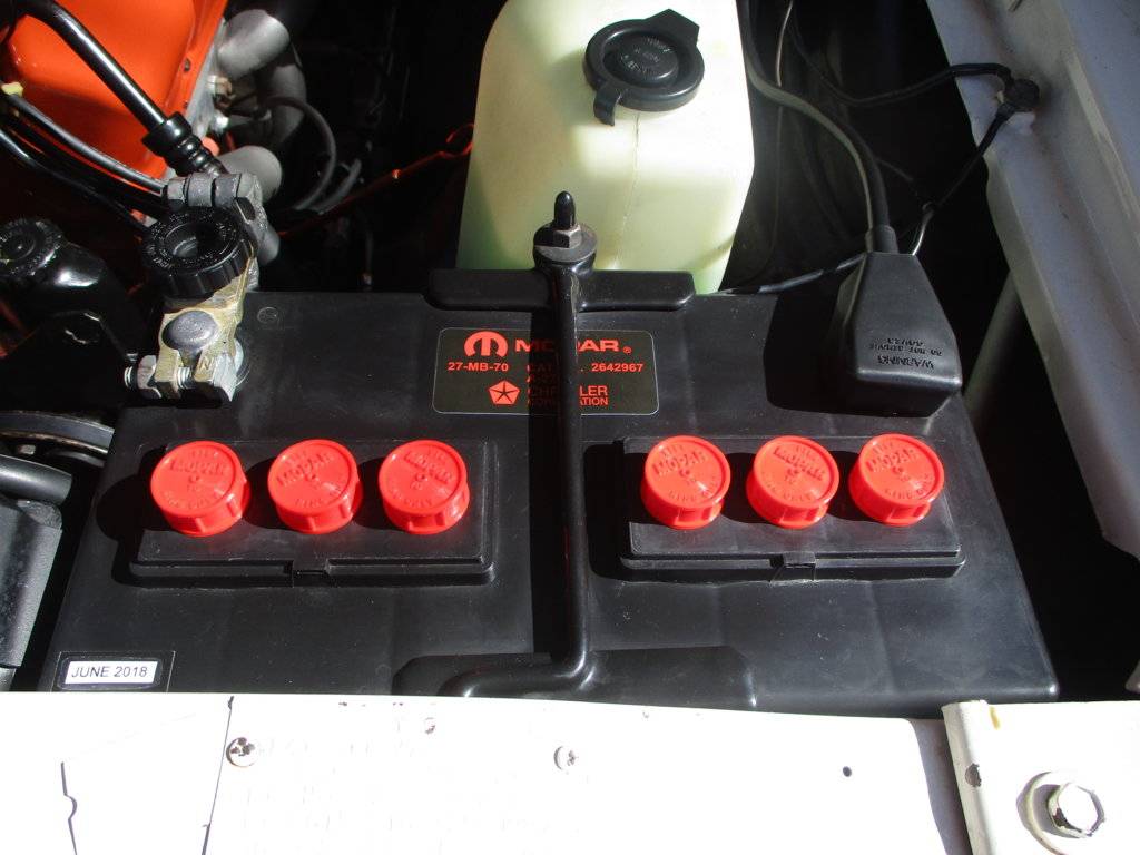

I just bought a group 24 650 cold cranking amp battery for my '62 300. A group 27 would also fit the battery tray. Same goes for your Newport.
I like having a big, fat Group 27 in my car.
Group 27 in my car. The OP better be checking out the wiring in that car before doing anything else. Probably going to find a multi colored nest.

Group 24 and Group 27 batteries have been pretty common on Chryslers for decades, probably even farther back then your '62, I suspect (but have never researched it myself).
You might also look at www.jholst.net for pre-66 Chrysler parts and service information. The website is oriented toward the C300 and 300 Letter cars, but the parts books and some other items are not letter car specific.
I'll concur that you need to investigate the charging system wiring schematics.
When I was driving our '66 full time, I wanted the Group 27 in it to have the strongest battery, for general principles (Grp 27 came with the factory a/c option). But the modern Group 24 probably has more CCAs than the older Group 27s did, I suspect. Therefore, to get things going, it might be advisable to get a more inexpensive brand of Group 24 and go from there. Might initially save a few dollars that can be spent elsewhere? When you get things sorted out, then you can upgrade to a good Group 27 if desired.

Howdy! All of the comments are correct, of course! I own a '57 300C, '61 300G, '68 300 and a '64 Imperial. These are big engines! Each one runs with a group 27 battery. The more options, the better you'll be. I have been using Antique Auto Battery for my classic batteries and couldn't be happier. That being the case, each one is connected to a Battery Tender and this device keeps them fresh. One of these batteries is 9+ years old. I wouldn/t be without them. The Tender maintains the voltage but doesn't overcharge like a trickle charger could.
Great site here! Lots of helpful folks...good luck but I would opt for the group 27. Good luck on that '62 yacht!
