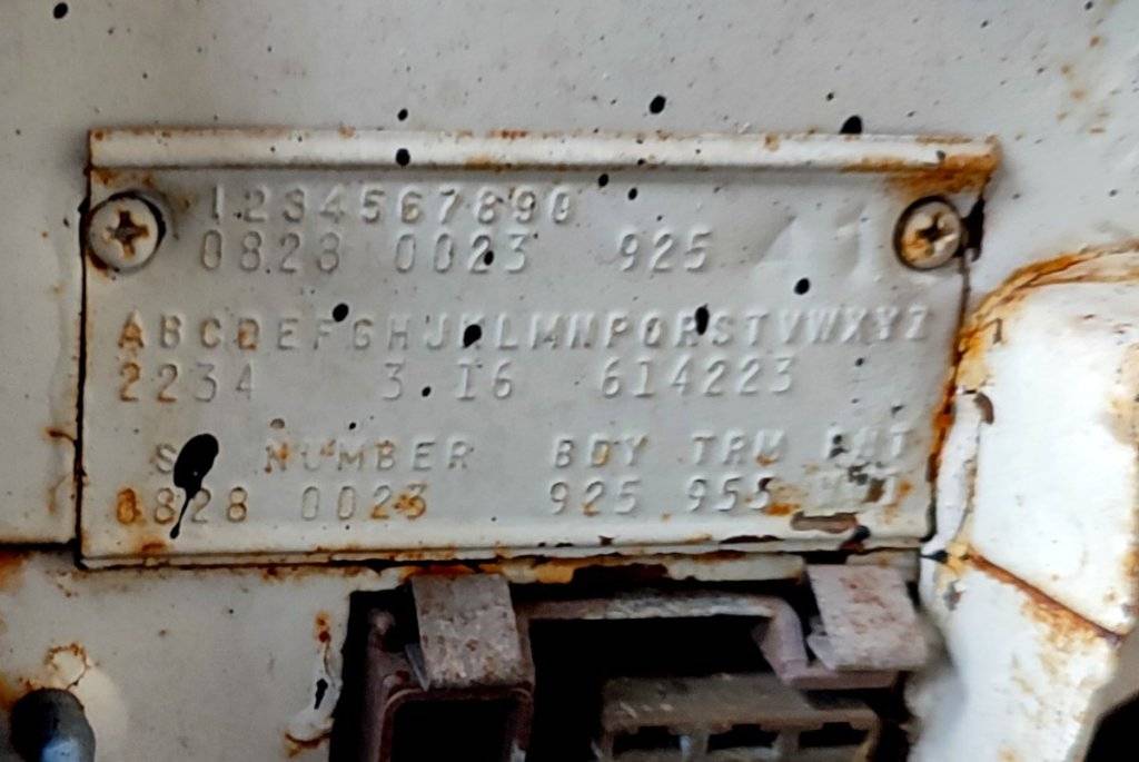

I took a pic of the data plate, can someone decipher the options? I already know it's a very first model (08/28), sequence number 0023. Trim 955, red leather & vinyl. The VIN is 9233102465.
What interests me is what is coded in the middle: A2, B2, C3 etc...
Thanks
