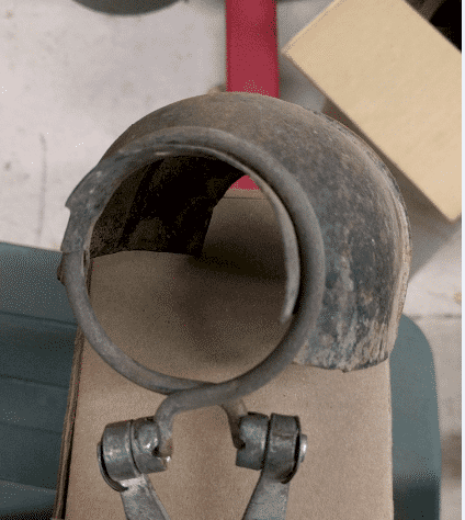

I'm pretty sure 65 Polara is same as Chrysler....... so here goes.
A standby from the stash.

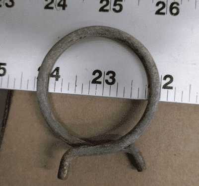

Couldn't find my calipers, so this is it.

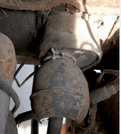

As installed.
Hope you can use these.
As per Polara 500, I believe this is the correct clamp. But you're going to have the column disassembled . . .
