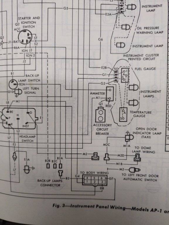

I'm troubleshooting my backup lamp circuit and was hoping someone could help me with locating two components listed on the instrument panel wiring diagram. I attached a picture of the instrument panel wiring diagram. The backup switch itself and the 6 pin body harness connector. I can't seem to find either of these. Any help greatly appreciated. Thanks in advance.
Thanks I've identified the backup switch. Any idea on the six pin body wiring connector? I traced the wires white to the 12v splice and purple goes into the harness and runs towards the passenger side.
I believe that you are referring to the bulkhead connector. The big one in the firewall by the master cylinder that has 3 connectors. This is one of those connectors.
