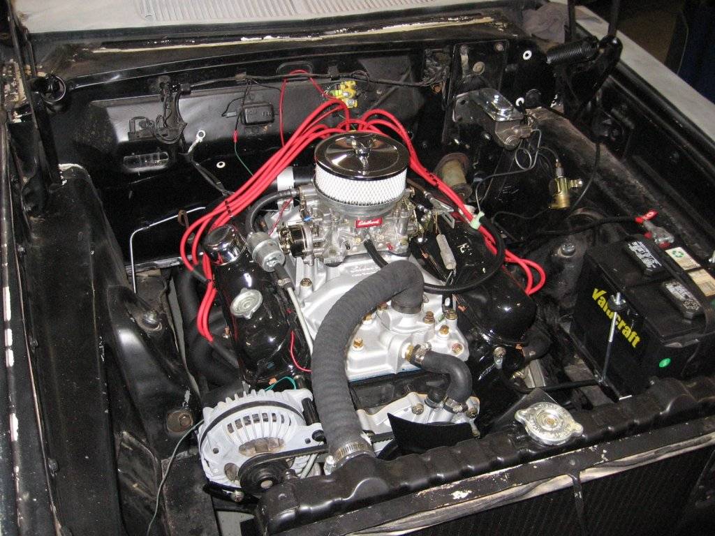

Budget is key. Low or not a problem ? My budget LA 318 mild build that sounds good and will light the tires.
Whoa!! No power steering or brakes; what's it in?
Forgot to say a 63 Plymouth Belvedere B Body.
Now has PS and A/C. Just a beater,nothing fancy.
