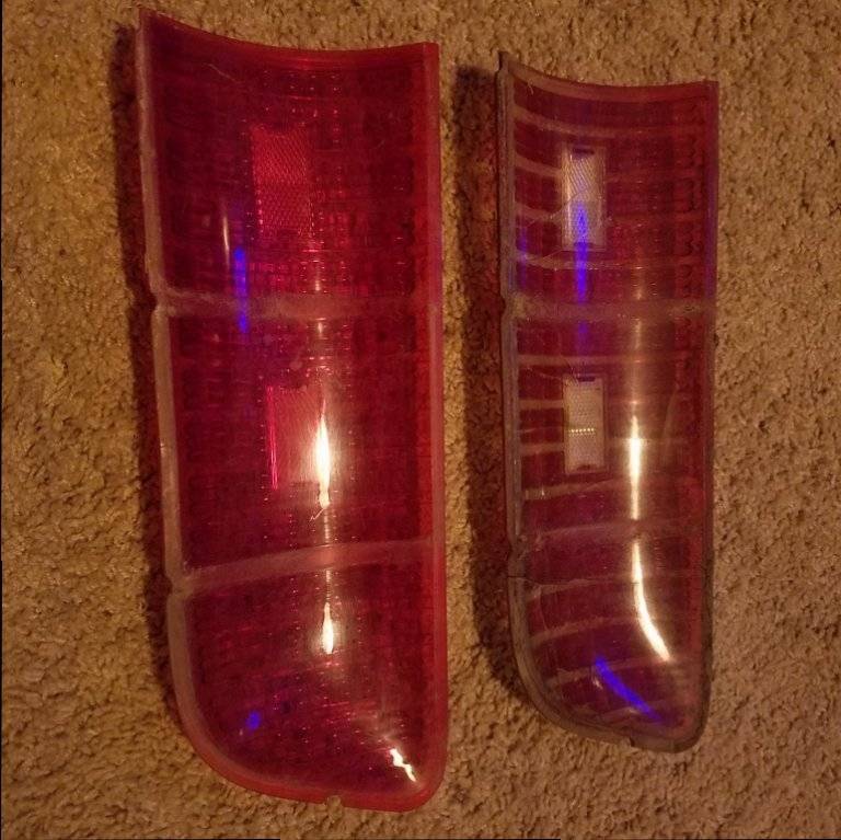

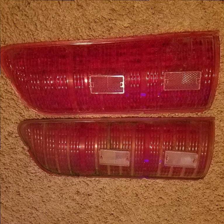

Hey guys,
Trying to figure this out...... same part number 2445950 rh lense
The weathered one is original. Notice on the original....the vertical "stripes" are clear...and has clear insert "windows" on the face.
Thanks!
Also..... on a similar note....the original backup lenses (RH 2445932 LH 2445933) are completely clear...... the disassembled tail light ....backup lense (RH 2445970) has silver "stripes"...similar to the "clear" tail assemblies from early production NYers.
This has me discombobulated!!!! Any ideas?
There were at least 6 different tail light configurations in 1965. Could be because of the vendor or it could be because one is aftermarket replacement.
The configurations I have seen are
1. Clear lenses with single tail bulb.
2. Clear lens with dual bulbs
3. Plastic lens with single bulb
4. Plastic lens with dual bulb
5. Plastic lens with single bulb - No backup light
6. Plastic lens with dual bulb - No backup light
There might be a 7th - clear lens without backup light - but I have never seen one yet.
Hope that helps clear (or create) some confusion...................

On the lenses themselves. I think the ones with the little white reflectors were early design. They changed to the little red reflectors because of federal laws stating there had to be red reflectors on the rear, and there could be no direct (unshaded) white light showing at the rear while the car was in any position except reverse. The silver strips - my theory (and I could be incorrect) is they were dropped for one of the same reason the clear lenses were. They were more expensive and complicated to make than the all red ones.
My '65 New Yorker has clear lenses, with rectangular red tabs in the centers. There are also vertical stripes. Backup lenses are clear. Great price for the grill and headlight assemblies!

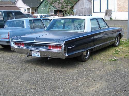

I've got clears too, notice the pic, if anyone gets a lead on someone re-manufacturing these, let me know.
