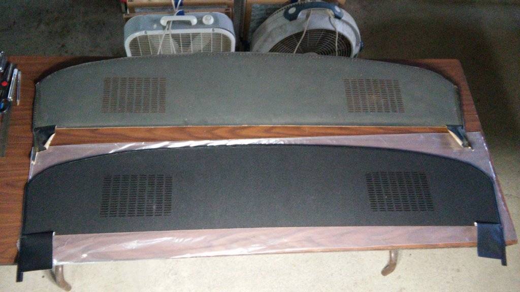

anyone know where to get these? Only ones I've seen are the ones on eBay. Has anyone bought one?

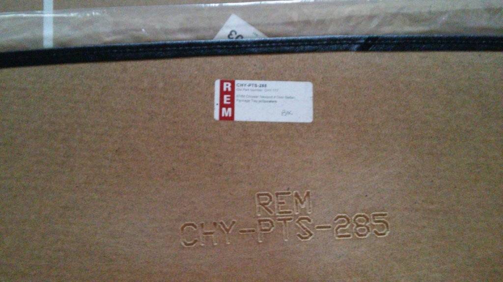

FWIW, I bought one from eBay from user musclemaniac. It's made by REM and fit well. Basically identical to the original.

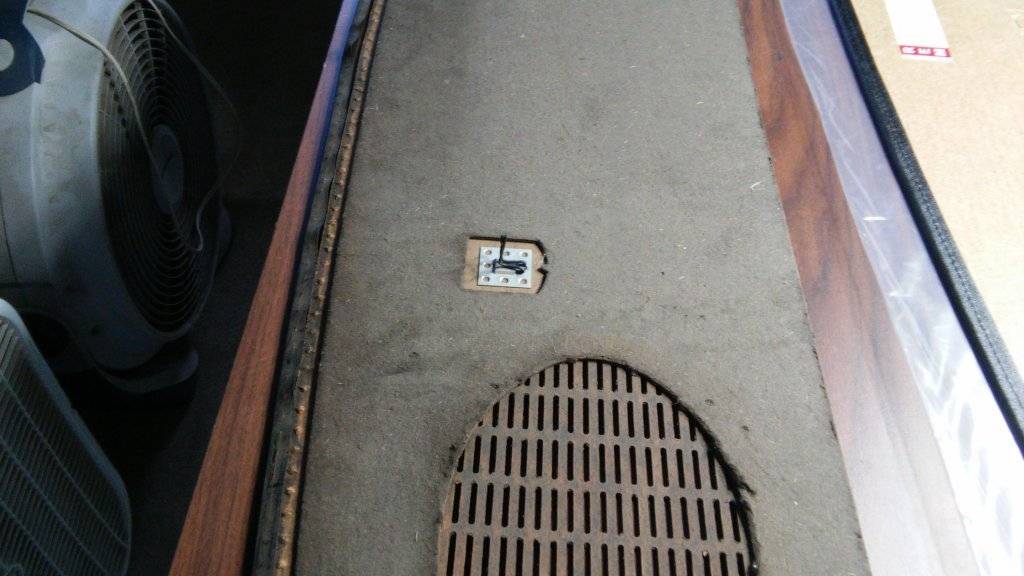

It did not come with the anchor clips or their holders. I transferred my originals.
Refer to my headliner thread for more info.
Hope the input helps.
John
Thanks John. I ordered mine off eBay from carpartjim so we'll see how it fits when it gets here. Thanks for the info

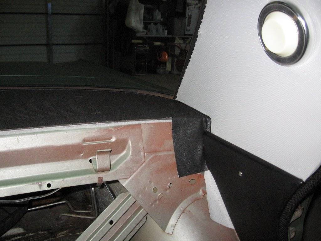

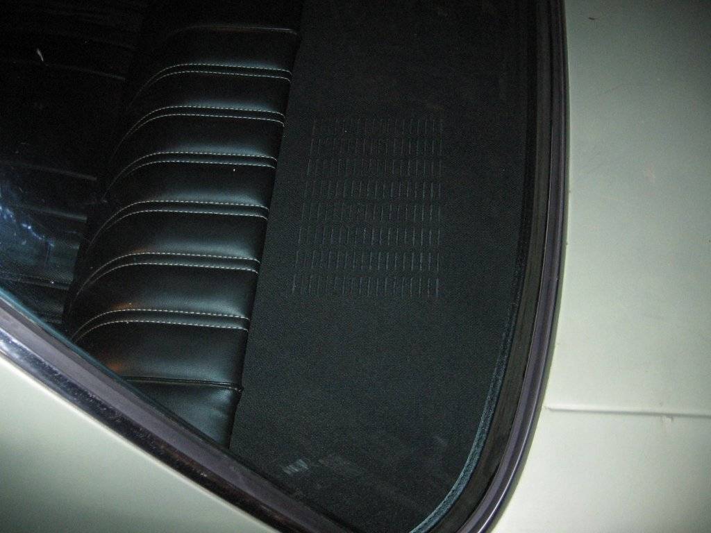

The thing I noticed on mine from REM was that it did not have the vinyl trim cord around the edge ( I don't think any do)My original had vinyl cord trim stitched to the sides and back of the board I believe as a transition trim piece between the sail panels and the board. At least that's how I remember it. Anybody have pictures showing this trim? Mine was too rotten to tell how it was done. 68 polara.
Keep in mind that these are pics of a '67 4DSD, different from a '68 2DHT.
Also, '67 2DHT's had one year only flow thru ventilation, so the '68 package tray is different from '68 as well. '67 is a steel mesh to allow air flow.
The replacement from REM was identical to original in every way except that it did not have the anchors for the hold down clips. I transferred anchors from a '67 2DHT and used epoxy to fasten them to the new.
