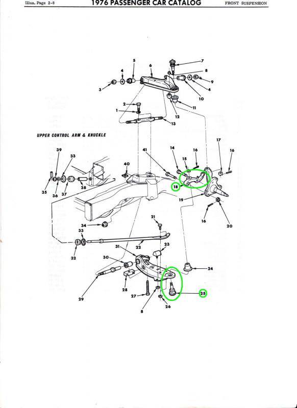

On the '73 and back, the ball joint did not mount in the lower control arm, it was part of the swing arm... #25 & #18 would be one piece.
Im sorry i left out that i used the lower arm and ball joint off the 74.the 66 top arm and ball joint fit the 74 spindle.
