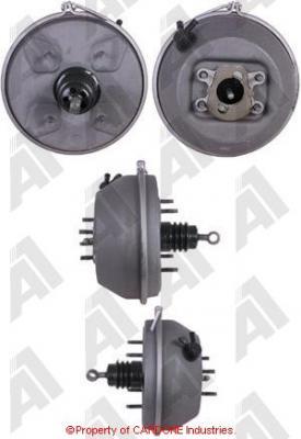

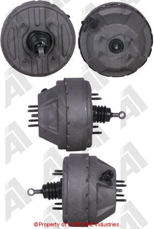

Note that the Bendix booster (if it's the dual diaphragm one used for DISC brakes) may be a bit overboosted when used on a drum system. I suggest finding the correct drum booster (I think it's Kelsey-Hayes or Midland-Ross - can't remember) and using that. Just like the proper power brake pedal setup, there must be many many of them out there in wrecking yard land.
That Bendix booster (if it looks like the picture below) is worth money - it could easily fund your purchase of all the parts noted above.
The drum brake booster looks like this:
