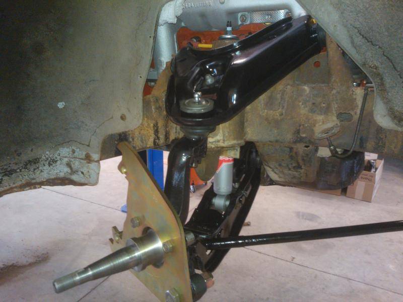

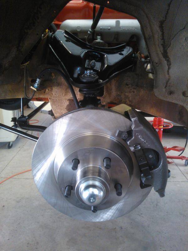

I recently installed a Scarebird kit on my '68 Polara, it is very inexpensive, you can keep you original spindles, and all the brake components are easy to find "off the shelf".

The Scarebird kit was $160 if I recall, all the brake components (hub & rotor assemblies, bearings, calipers, brake pads, rubber brake lines, master cylinder, and a couple other misc things) were about $300-$400. I figured multi-piston calipers, as those that come in the other aftermarket kits would be a bit of overkill for my purposes. The kit for my Polara uses mid '90's Dodge 1/2 ton pick-up calipers... plenty of stop for a non- track car.

The only downside to the scarebird kit is weight, tis very heavy - not far off what the factory setup is - if only they had sourced a lighter caliper.

Also, if you dont have 15 inch wheels, you will need them to clear the brakes
