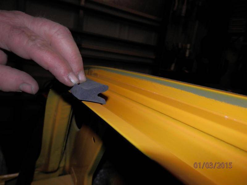

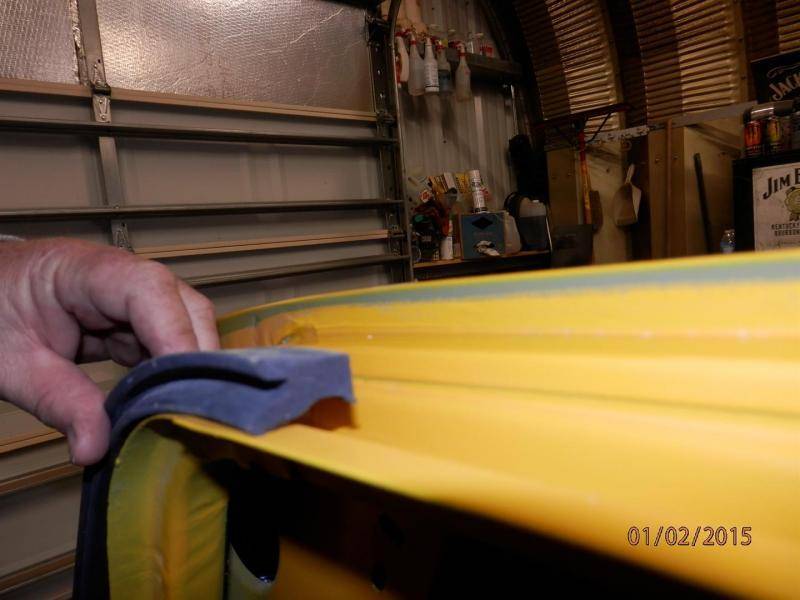

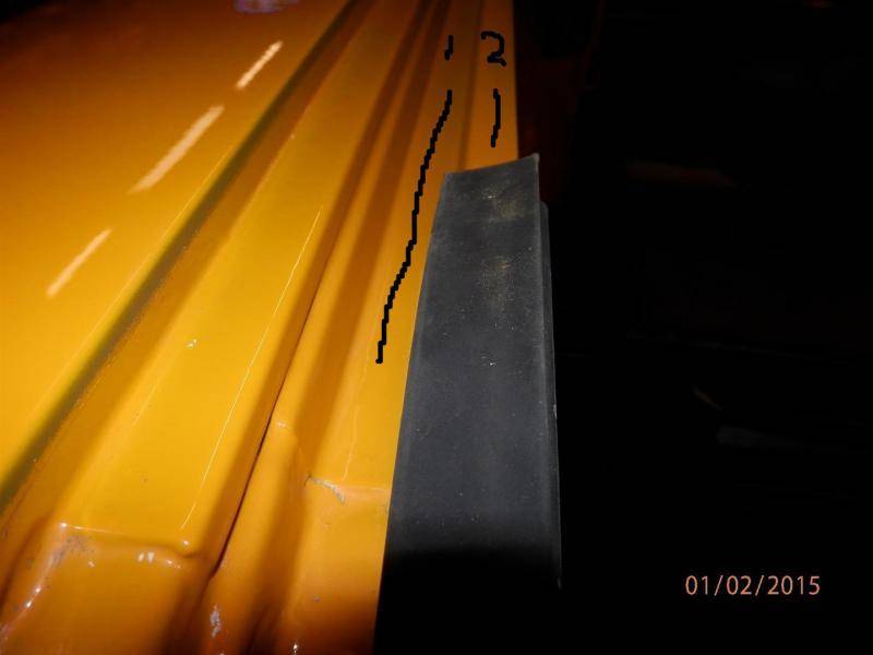

Not sure if1. I have the correct seal, or 2. If I do, how it attaches to trunk. Does it set down in the rail(1) or glue on top(2)?

I believe you have the seal turned 180°.
That is the "C" shape should face away from the opening rather than towards it.
Roger that...now, does it glue to the top rail, like shown(2), or down in the U shaped rail (1). The seal is wider than rail(2).
Glues to the top rail (2) with the small groove in the bottom of the rubber straddling the rail.
Turn the seal 180° in your 2nd pic and you're there. It will make sense.
