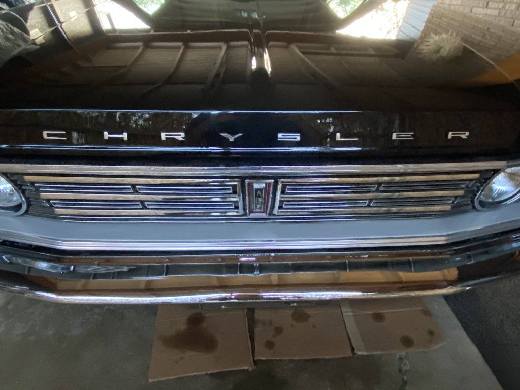

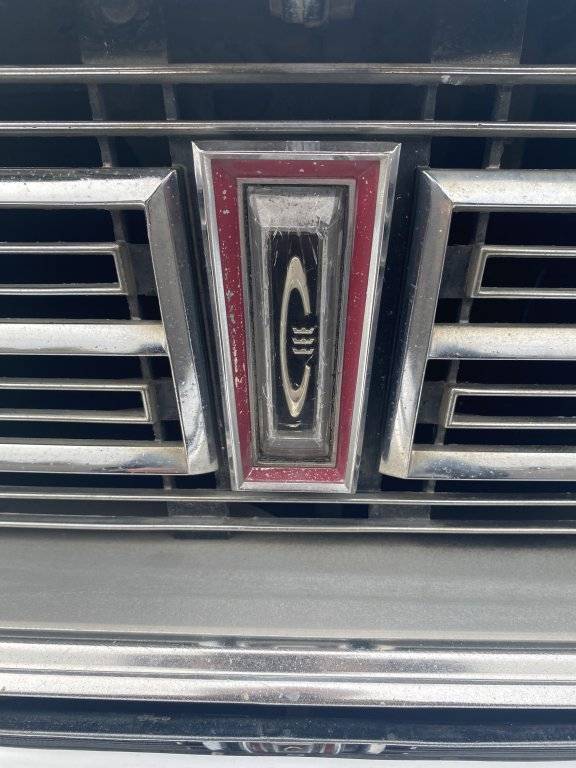

At some point soon I’m gonna repaint all of the flat black and polish every last bit of chrome on the grille. I did the headlight bezels already since those are removable.
Spent a few hours with a scotch brite pad scouring off decades of grime from the chrome parts of my grille, and then used some semi-flat Testors to repaint all the vertical “blackout” areas. The only part I didn’t get to yet is the thin black line in the center section of the ornament. I’ll have to find a way to either mask or use a qtip to clean up my mistakes. I’ll give it a go next weekend.

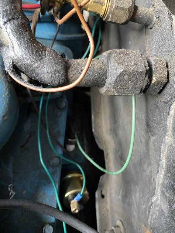

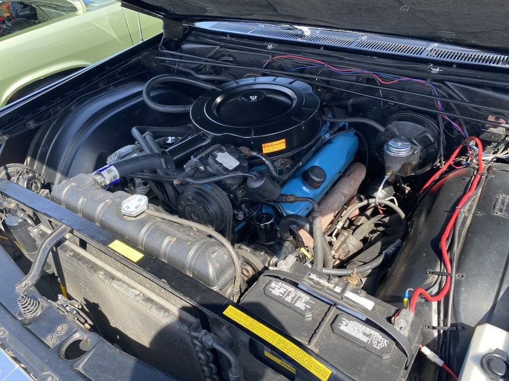

Finally got this infernal contraption installed and working.
Had to move the factory sending unit for the dummy light over to the other side since the sending unit for the gauge was too big and bumped into the intake manifold cross bracket thingy.
Used a M10x1.00 female to 1/4" NPT male adapter for the factory sending unit in the passenger side hole.
~60 PSI at a fast idle (800 rpm), 30 PSI at warm idle (500)
Had to break down and buy this to get the factory sending unit out. None of my buddies in town had one. $12 @ O'Reilly.

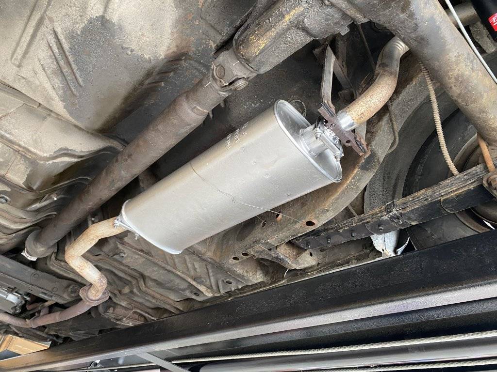

Muffler replacement BEFORE and AFTER.
The generic muffler that was installed on SS Anderson was damaged during transport by a shipping company. I told the PO not to worry about replacing it before the sale and that I'd take care of it. Here's a short video of the exhaust note with it installed.
BEFORE -

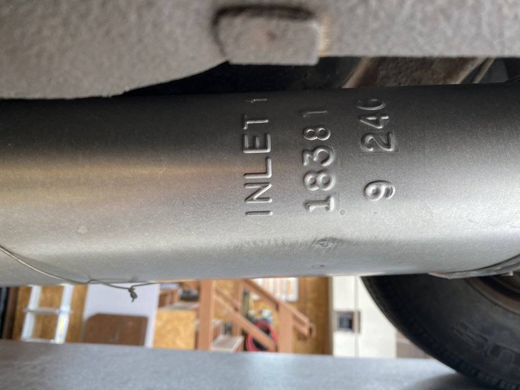

I installed a Walker 18381 which seemed like a close enough fit to my original. Had some fitment problems though, since I failed to measure my existing inlet and outlet pipes. My inlet = 2 1/4", the Walker inlet = 2 1/2". My outlet = 2", the Walker out = 2 1/2". Uh-oh. So until I can get some reducing adapters, I just used some HVAC tape to prevent some massive exhaust leaks. I'm pretty embarrassed by my mistake, but it actually didn't turn out too bad. No leaks YET . . .
AFTER -
Since I couldn't effectively clamp the muffler in place as it was, I'm using baling wire to keep the muffler from rotating.
Yes, this is embarrassing. Baling wire and HVAC tape to keep it together until I get some reducing adapters. Dual exhaust is in my future anyways, so this will get the job done for now.

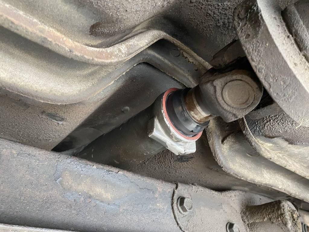

Also today while I had the car on a lift I replaced the "non-booted" output shaft seal on the transmission. I ran into a bit of an issue, nicking the "sleeve/bushing" that was in the output shaft with a screwdriver while getting the old seal out of the way. I made some adjustments to it so it didn't contact the driveshaft and I think I'm gonna be ok. If not, I'll have to take it all apart again and replace the sleeve/bushing. Crossing my fingers.

I added the black detail to the grille ornament over the weekend. There’s a tiny bit of cleanup to do with a qtip and brake cleaner, but aside from the crazed clear plastic, it looks better. I also repainted the satin black that should be on the sides and top of all the trunk and hood lettering. It really cleans them up.
